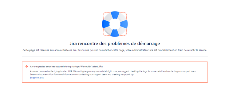

Below is the error message when logging into Jira:

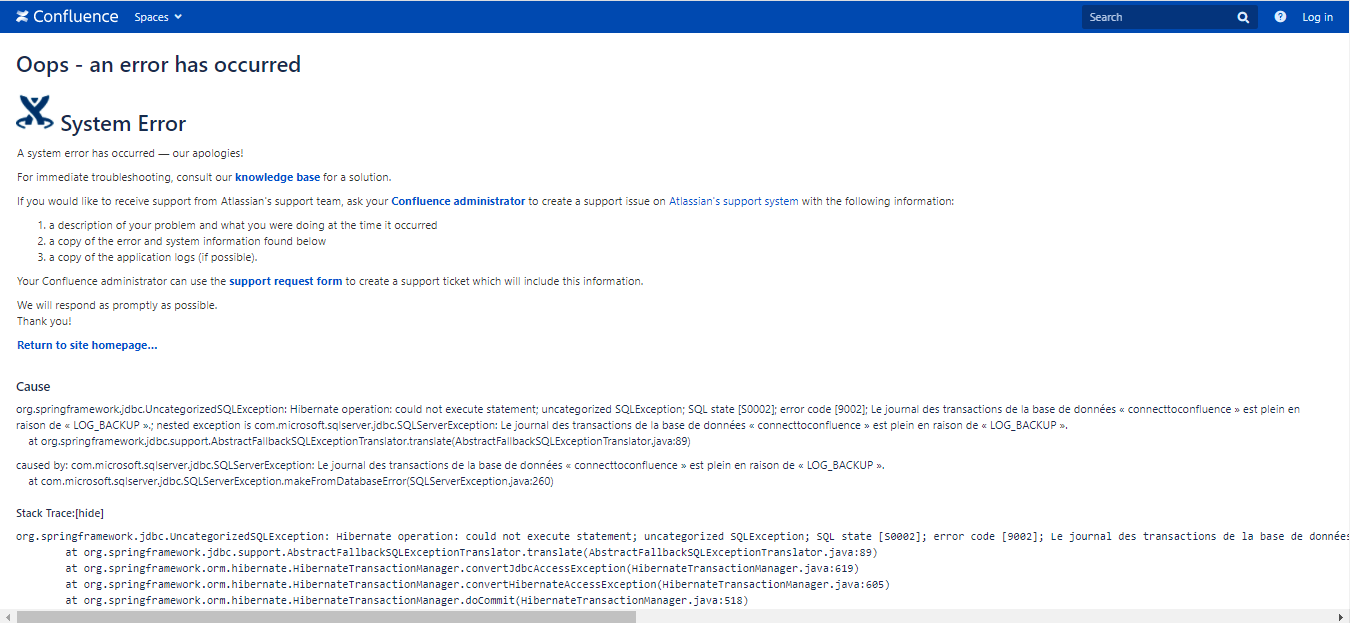

On confluence we have also some errors :
But the public part of Confluence still working perfectly (it's knowlege base for user)
