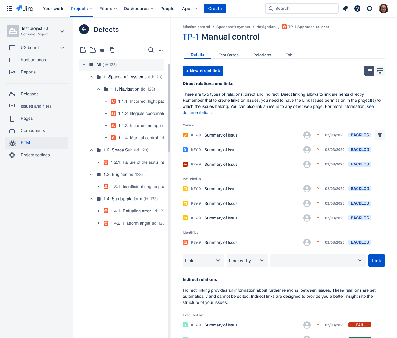

Bugs are usually reported in dedicated bug management software. If you’re a user of Jira, there are a number of plug-ins that you can check out in order to improve your defects reporting process. For instance, you can check out Requirements & Test Management for Jira (RTM) which includes ready-made layouts for efficient bugs description and shows relations between defects and other testing objects.
Defects relations in RTM for Jira

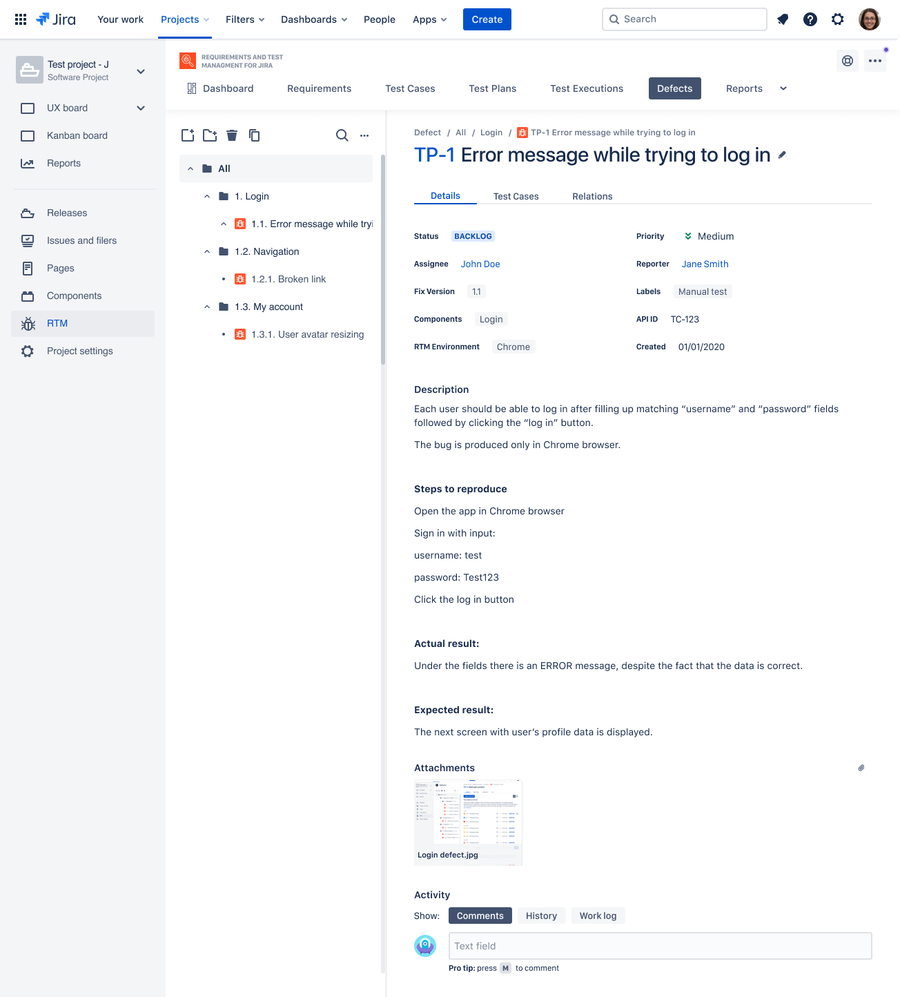

Example of a well-described defect in RTM for Jira
If you’d like to make your bug-detecting process more efficient, we highly recommend using dedicated bug-reporting software. Such programs are equipped with all the functions automatically preparing clear-cut, consistent defect descriptions. By following the indicated steps, you can be sure that the format is right and that no crucial elements are missing.
