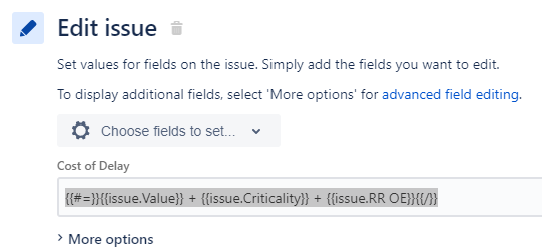

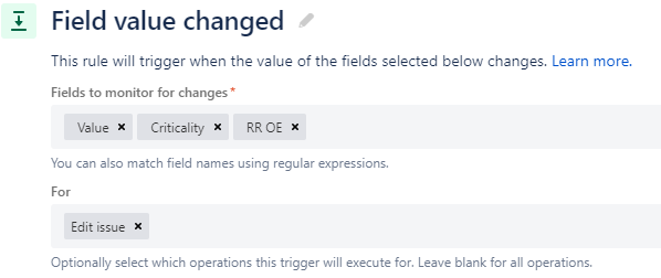

WSJF Automation part 1
This performs the 1st calculation, Value + Criticality + RR OE = Cost of delay
It is triggered by the “Field value changed” trigger, with all 3 fields involved in the calculation as trigger points for the “Edit issue” or “Create issue” operations.
Then the “Cost of Delay” field is populated based on a Smart Values calculation {{#=}}{{issue.Value}} + {{issue.Criticality}} + {{issue.RR OE}}{{/}} via the “Edit issue” action.

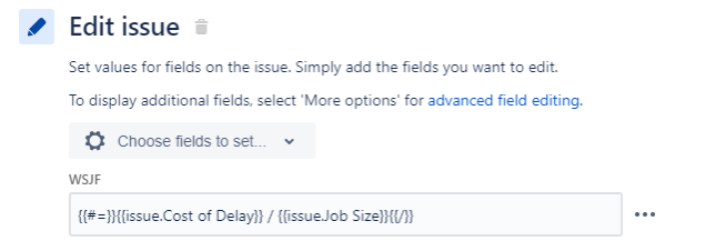

WSJF Automation part 2
This performs the 2nd calculation Cost of delay divided by Job Size = WSJF
Again, triggered by the “Field value changed” trigger. This time by the “Cost of Delay” field upon the “Edit issue” or “Create issue” conditions.
- Then the “WSJF” field is populated based on a Smart Values calculation {{#=}}{{issue.Cost of Delay}} / {{issue.Job Size}}{{/}} via the “Edit issue” action.
Note: WSJF Automation part 2 always triggers as the “Cost of delay” field changes as a result of WSJF Automation part 1.

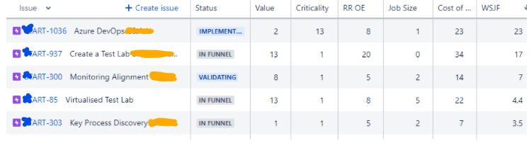

Now create a plan using Advanced Roadmaps
This is a great use of Advanced Roadmaps where you take advantage of its spreadsheet like view, rather than its timeline features.
It gives you the ability to do a WSJF session directly into the plan, then update the fields back into Jira once agreed upon.
- Create a plan that filters in the relevant issues that have the WSJF fields.
- Add the WSJF custom fields to your plan and add them as columns
- Now commence updating the “Value”, “Criticality”, “RR OE” and “Job Size” fields, then, when ready, click“Review Changes” and save back to Jira.
The automation will do the math and upon a refresh of the plan, the Cost of delay and WSJF fields will be populated.
Sort by the WSJF column and you have them in highest to lowest order ready to help you make those priority decisions.
The Net result
The net result is, you now have a reusable plan that can act like a spreadsheet with formulas that records the data back into Jira on the Features the data pertains to.
