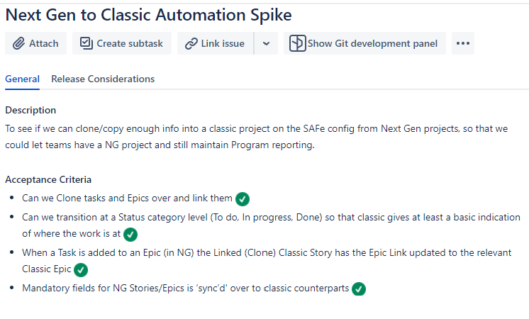

Below is the user story (written in Next-gen/Classic terminology)
The problem statement: How can we maintain Programme/ART level reporting (where we use a standardised SAFe workflow scheme for all ARTs) while allowing certain teams to experiment with Next-Gen (Team managed) projects.
The acceptance criteria were all met using automation for Jira on Jira premium cloud.

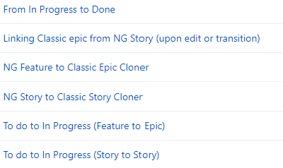

Below are the titles of each automation:

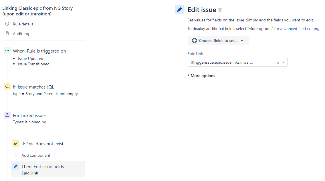

The "Linking classic epic from NG Story" automation is probably the most cryptic in terms of description and was the hardest to conquer. The idea being, we need a way to sync any stories linked to a Next Gen Feature but post creation of that story (a likely scenario)
