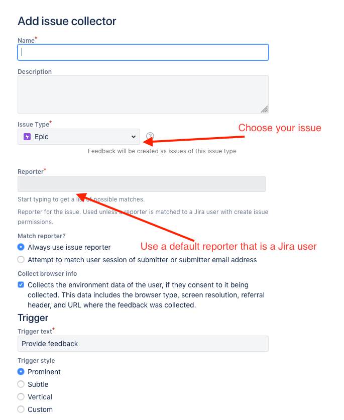

To create an Issue Collector, go to your Project Settings > Issue Collector click on "+ Add issue collector". Fill up the configuration form according to your requirements.

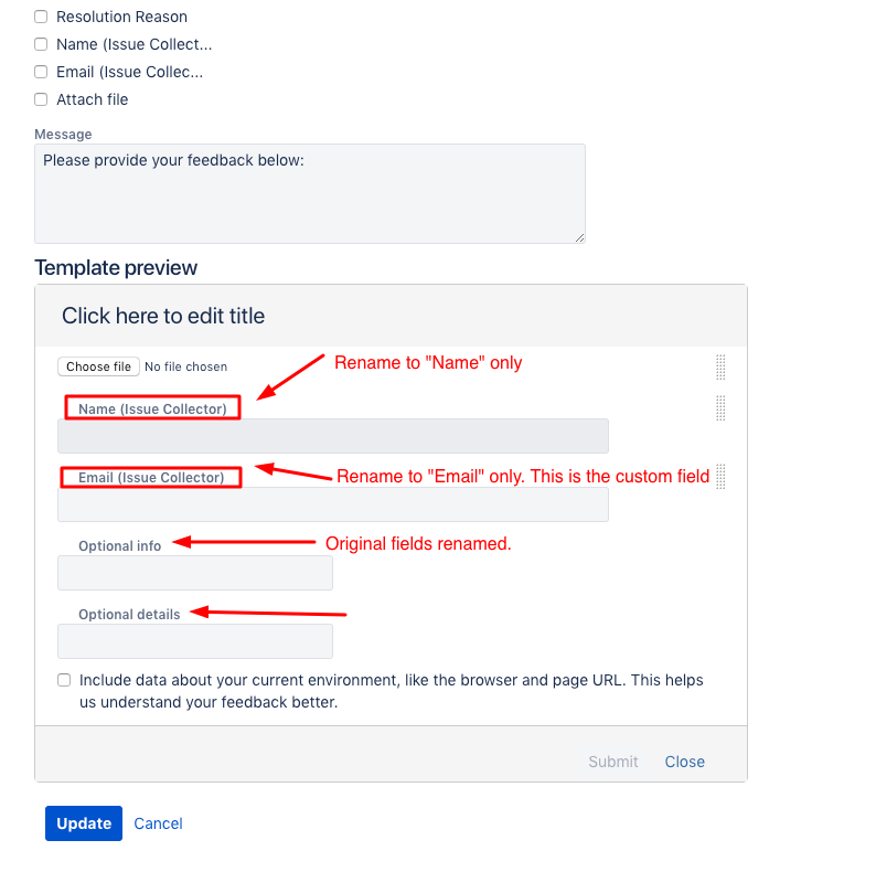

Question. How to make the name and email field required?
First of all go to your custom fields create two new custom fields using the text field (single line) field type. you can name it Name (Issue collector) and Email (Issue collector) for easier reference.
After that is done, go to your Jira Settings > Issues > Issue type Screen Scheme
Locate your project <NAME> the one you want this Issue Collector associated to and click on "configure" Then click on the appropriate issuetype “Screen Scheme” link
After that, click on the appropriate Screen.
Add the two new custom fields you just created
Then click on the field configuration locate these two fields and click on "Required" link.

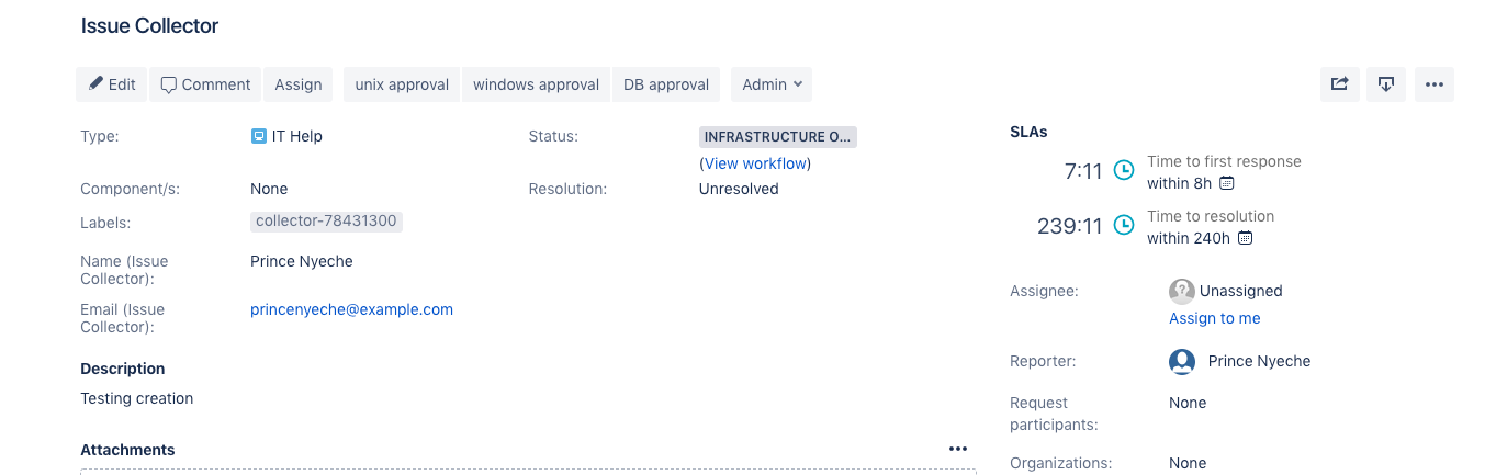

Once the above is done, you can go to your Issue Collector scroll down to the Custom field and tick the two new fields to be added to the Template preview.
Rename the previous "Name and Email" fields to "optional info and optional details" then Edit the "Name (Issue Collector) and Email (Issue Collector)" to "Name and Email"
Update to save changes and test out the fields.
If done successfully, the end result should look like the below, once the form has been raised.
