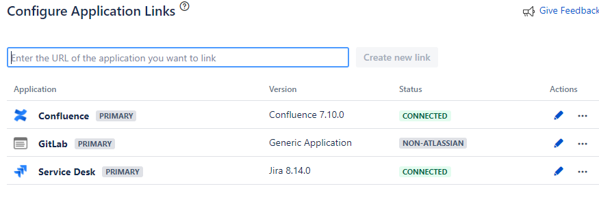

We have a Server running Jira Software Version 8.14 and Confluence 7.10. That server is running in subnet X. In a DMZ in subnet Y we have a Server running Jira Service Management 4.14.0 based on Jira Core 8.14.
All instances have application links between each other, so that references should work.

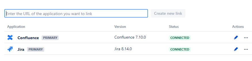

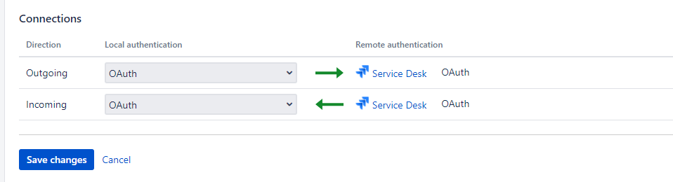

Application Link Status in Service Managment to Jira Software is fine. Connected in Both directions with OAuth Authendication.
