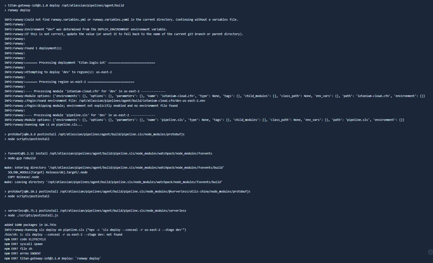

So our pipeline broke 6 days ago, nothing have changed. Just suddenly stopped working.
We are using
- onica/runway @1.5.2
- serverless runtime:nodejs12.x
- bitbucket image: circleci/node:12-browsers
Last working pipeline
Broken pipeline

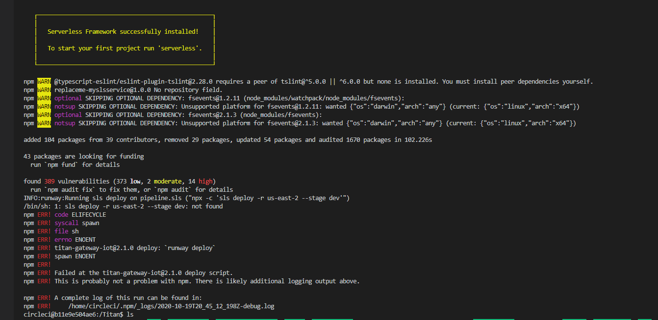

I tried local docker with circleci/node image and is able to reproduced the error...
This is a big blocker for us
is there a change on Bitbucket Build Server that might cause this? We are really not sure what to do, as we didnt change any packages...
