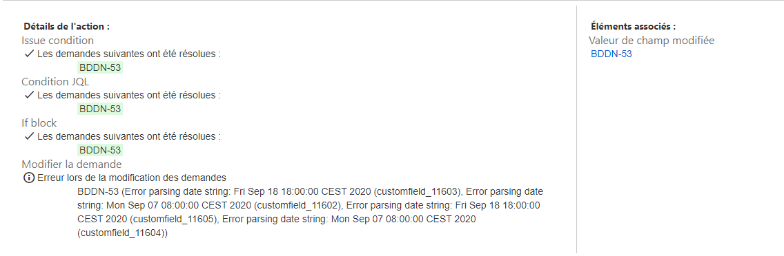

I've put in a place an automatic rule that where a date custom field takes (start date) the value of another date field (Sprint Start Date). I've been getting this error:
BDDN-265 (Error parsing date string: Fri Sep 18 18:00:00 CEST 2020 (customfield_11603), Error parsing date string: Mon Sep 07 08:00:00 CEST 2020 (customfield_11602), Error parsing date string: Fri Sep 18 18:00:00 CEST 2020 (customfield_11605), Error parsing date string: Mon Sep 07 08:00:00 CEST 2020 (customfield_11604))
Our Jira is configured in french and I suspect it has something to do with that. Any idea how I can fix this?

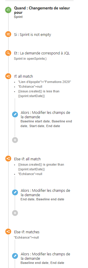

Here's the rule (in french) and its translation below:
The translation :
When : the value of the Sprint field changes
If : Sprint is in openSprints() (JQL request)
If : Epic Link is different than "Formations2020"
And : "Due Date" is NULL
And : date of issue creation is less than Sprint Start Date
Then : Modify the value of the following fields :
Baseline start date takes the value of Sprint Start Date
Start date takes the value of Sprint Start Date
Baseline end date takes the value of Sprint End Date
End Date takes the value of Sprint End Date
Else-if : date of issue creation is greater than Sprint Start Date
Then: Modify the value of the following fields :
Else-if : "Due Date" is not NULL
Baseline end date takes the value of "Due Date"
End Date takes the value of "Due Date"
[End of Rule]
The result of the audit log:
