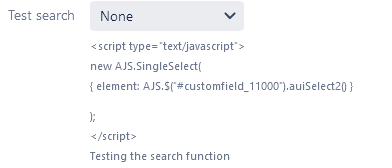

I have a project that have a large Single select list on the create screen. They want to make it searchable. I found a few suggestions about adding a javascript to the field description. That works fine. But the seach is a bit limited, it only searches from start of words. I found that auiSelect2 provides a better seach, see this post. However, adding that to the javascript gives me two select lists on the create screen.
The first behaves like a auiSelect2 and the second like the searchable select list.
I have created the script with input from different posts. What have I missed for it to give me the two different lists?
<script type="text/javascript">
new AJS.SingleSelect({
element: AJS.$("#customfield_10233").auiSelect2()
</script>
Is there perhaps a better way to do this? It seems like the possibility to add javascripts to the field description has been removed in later verison. I tried this on 8.11.0 and it does not work. The script is displayed as the field description on the create screen.
