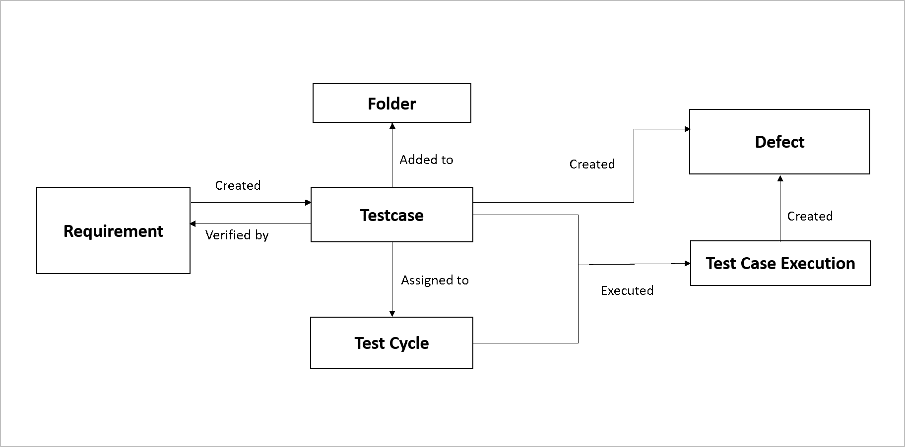

You may associate Requirements and Defect issues with Test Case and Test Set issues within the default linking mechanism. Following are the specific issue link types for associating these issue types:
- Requirement is verified by Test Case
- Defect can be verified as well as created by Test Case
- Defect can also be created during Test Case execution
- Test Cases are assigned to folders and also to Test Cycles for execution

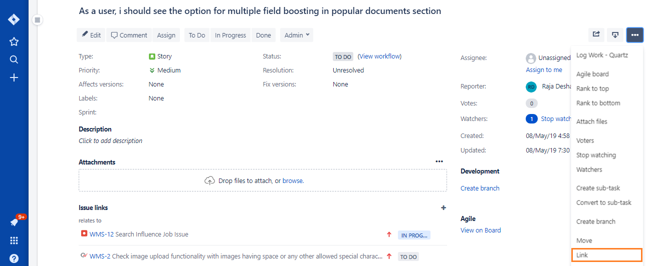

a] Starting with the Requirement View screen
To associate Requirement with a Test case from the Requirement view screen, follow the steps given below:
1] Open any Requirement with which you want to associate a Test Case. In the example that follows, Story issue types are mapped as Requirements.
2] Click on … > Link. The Link screen will appear, as shown below:
3] On the ‘This issue’ field, select the ‘relates to’ option from the drop down and to select Test cases to be associated, you may choose any of the following:
· Enter the desired Test Case Issue Key on the Issue field
· Click on the Down Arrow on the Issue field and select the Test case from its History Search list
· Click on the ‘search for an issue link’ to start using the Find Jira issues browser
4] Click Link.

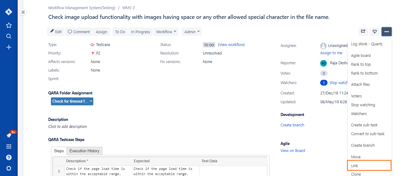

b] Starting with the Test Case View screen
To associate Requirement with a Test Case issue from the Test Case view screen, follow the steps given below:
1] Open any Test case with which you want to associate a Requirement.
3] On the ‘This issue’ field, select the ‘relates to’ option from the drop down and to select Requirements to be associated, you may choose any of the following:
· Enter the desired Requirement Issue Key on the Issue field
· Click on the Down Arrow on the Issue field and select the Requirement from its History Search list
· Click on the ‘search for an issue ‘link to start using the Find Jira issues browser
4] Click Link.

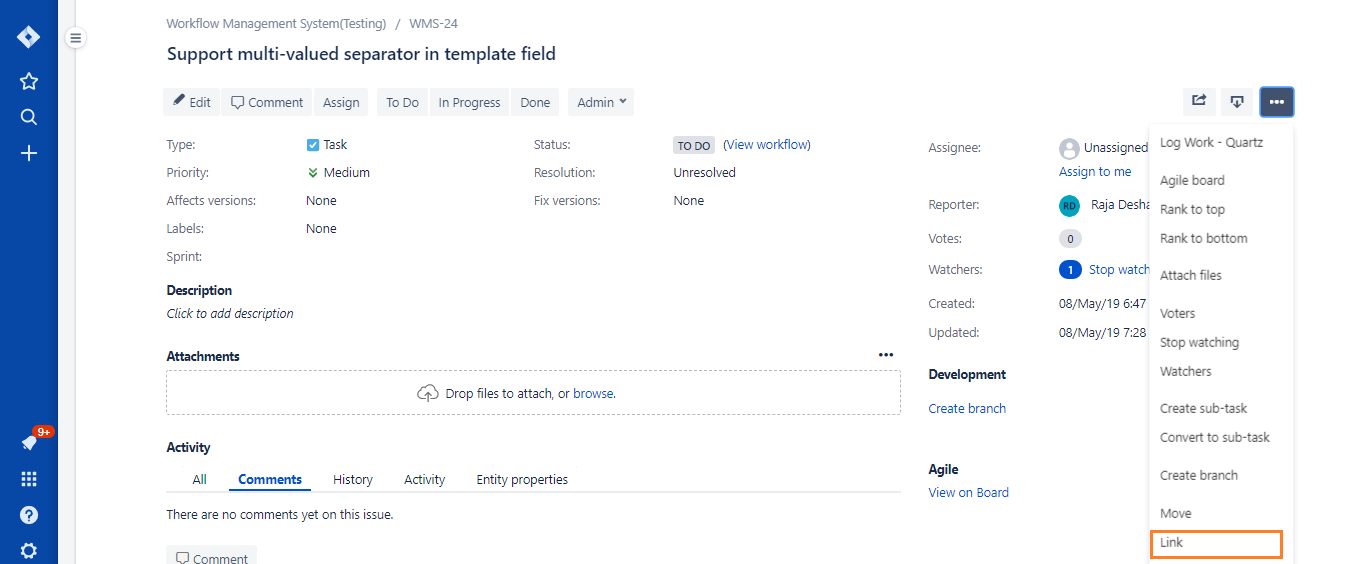

c] Starting with the Task view screen
To associate Requirement with a Test Case issue from the Task view screen, follow the steps given below:
1] Open the task with which you wish to associate a Requirement.
2] Select ... > Link. The Link screen will appear, as shown above.
3] On the ‘This issue’ field, select the ‘relates to’ option from the drop down and to select Test Cases to be associated, you may choose any of the following:
· Click on the Down Arrow on the Issue field and select the Test Case from its History Search list
· Click on the search for an issue link to start using the Find Jira issues browser
4] Click Link.

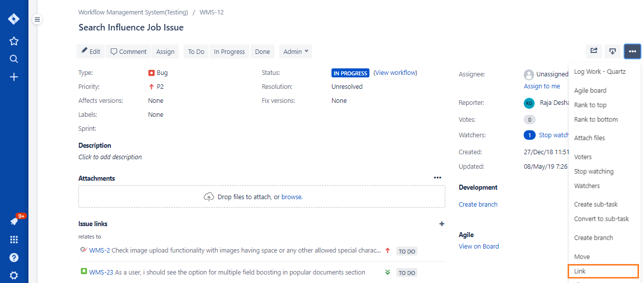

a] Starting with the Defect issue view screen
To associate Defect with a Test case from the Defect issue view screen, follow the steps given below:
1] Open a Defect with which you wish to associate a Test case.
2] Click ... > Link. The Link screen will appear, as shown below:
3] On the ‘This issue’ field, select either the ‘created by’ or the ‘relates to’ option and to select Test cases to be associated, follow the steps given below:
· Click on the ‘search for an issue ‘link to use the Find Jira issues browser
4] Click Link.
b] Starting with the Test case view screen
To associate Defect issue with a Test case issue from the Test case issue view screen, follow the steps given below:
1] Open the Test case with which you wish to associate a Defect.
3] On the ‘This issue’ field, select the “relates to” option and to select Defects to be associated, follow the steps given below:
· Enter the desired Defect Issue Key on the Issue field
· Click on the Down Arrow on the Issue field and select the Defect from its History Search list
4] Click Link
