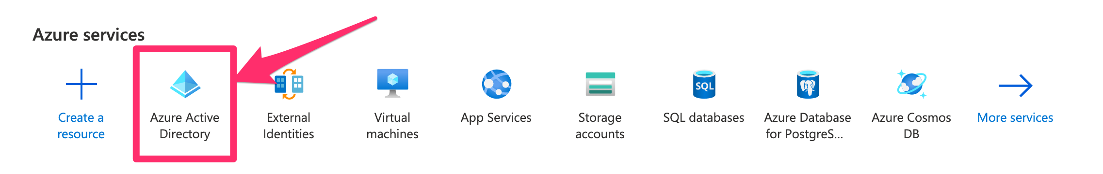

1. Sign into Azure and click on Azure Active Directory.

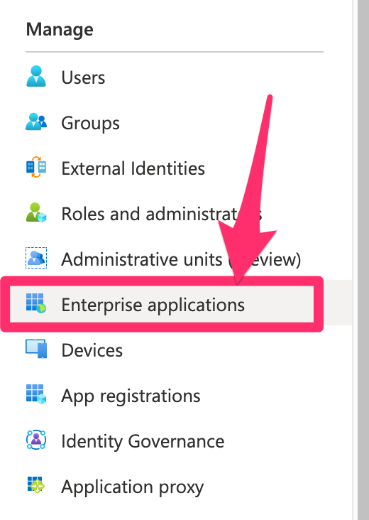

2. Select Enterprise Applications from Manage in the left column.

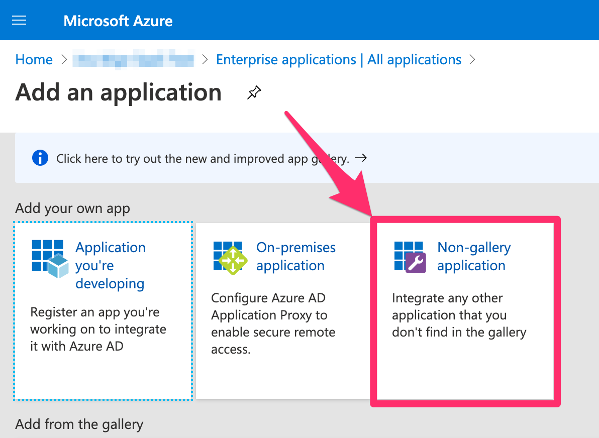

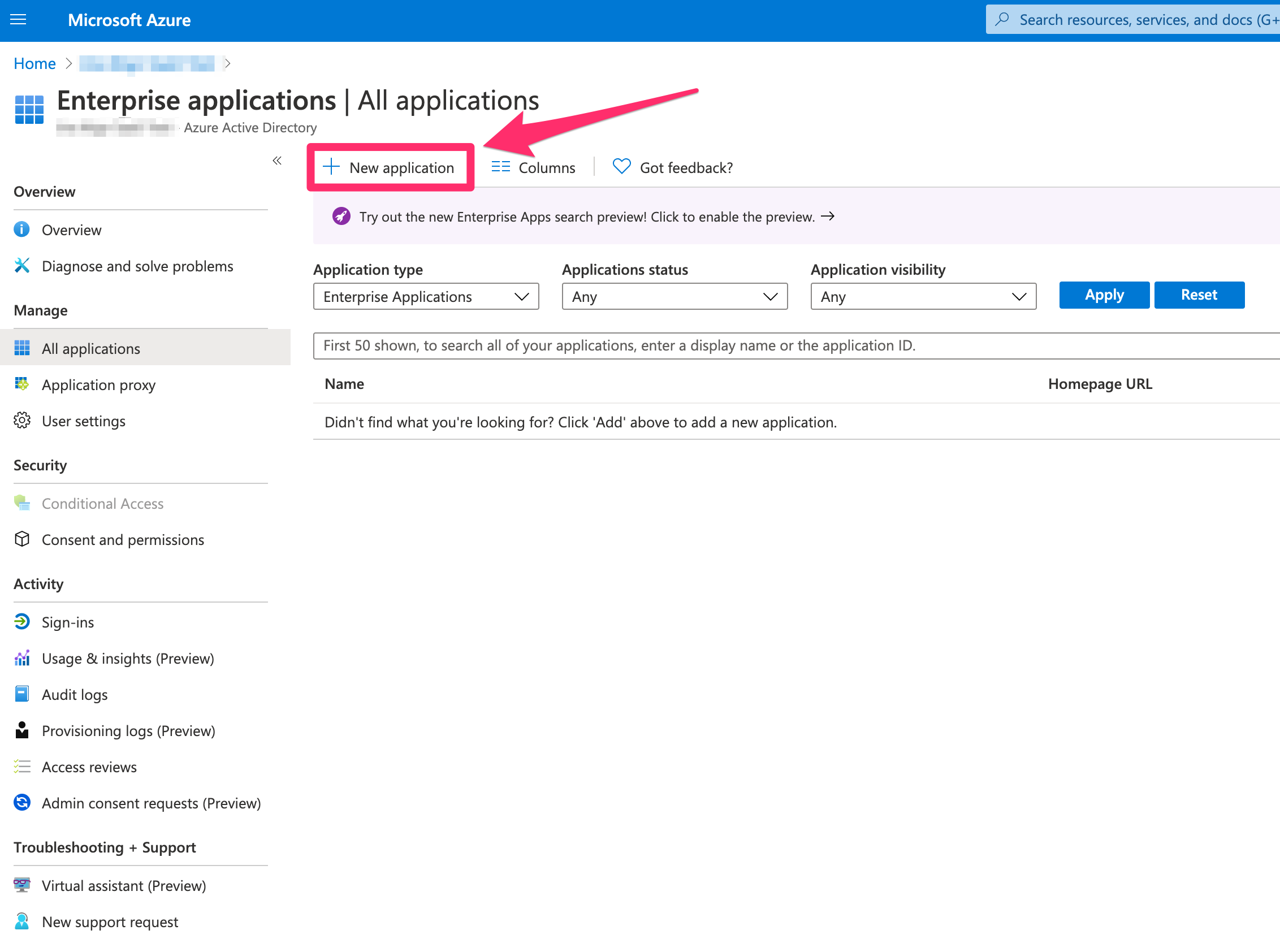

3. Click on New application.
4. Select Non-gallery application.

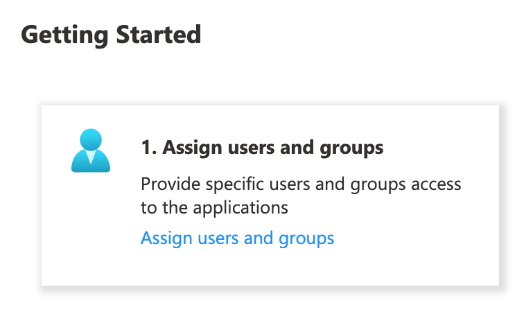

6. Under the Getting Started section, click on 1. Assign users and groups.

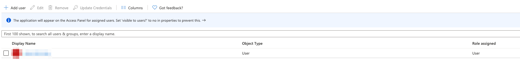

7. Click Add user and add Users as needed. You need at least one User to test SSO and you can go back and add more later if you want.
8. On the Add Assignment screen, you can select the users you want, click Select and Assign.
9. The user(s)/group(s) should show up on the Users and groups pane now.

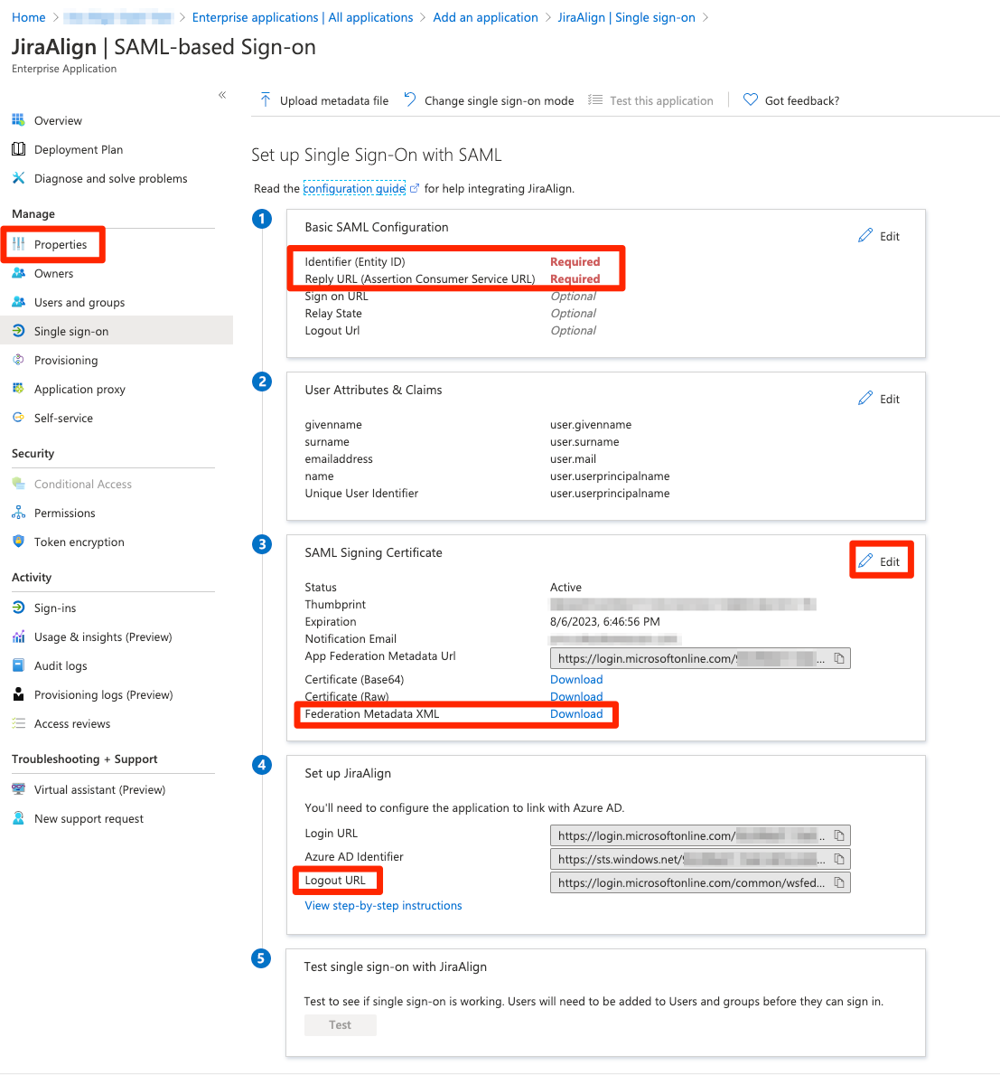

10. Click on Single sign-on and SAML.
11. In Section 1: Basic SAML Configuration, edit the Identifier (Entity ID) and Reply URL (Assertion Consumer Service URL) to both be the Jira Align instance:

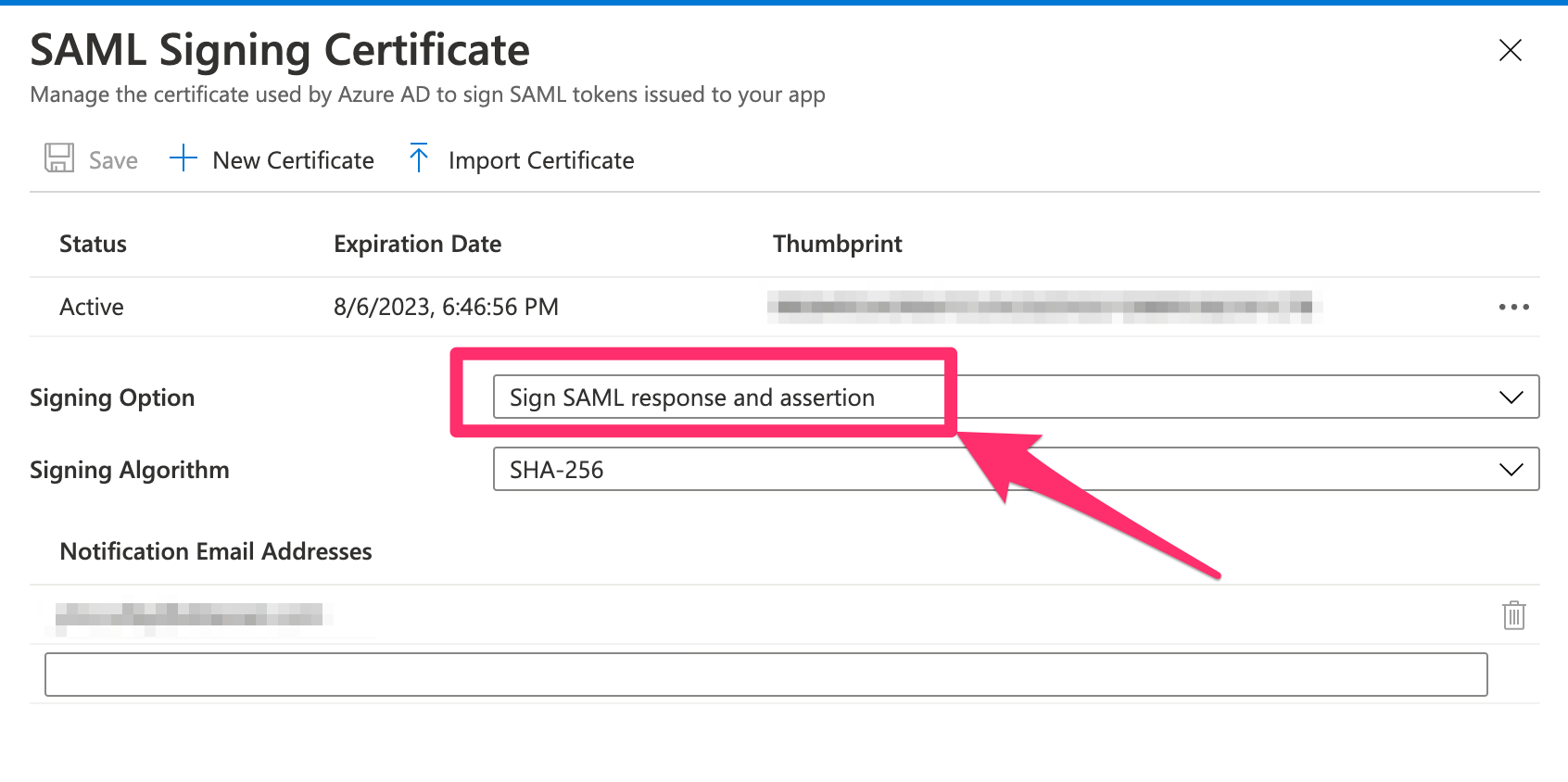

12. In Section 3: SAML Signing Certificate, edit and change the Signing Option to Sign SAML response and assertion. Click Save.
13. Also, in Section 3: SAML Signing Certificate, click Download next to Federation Metadata XML to use in a later step.

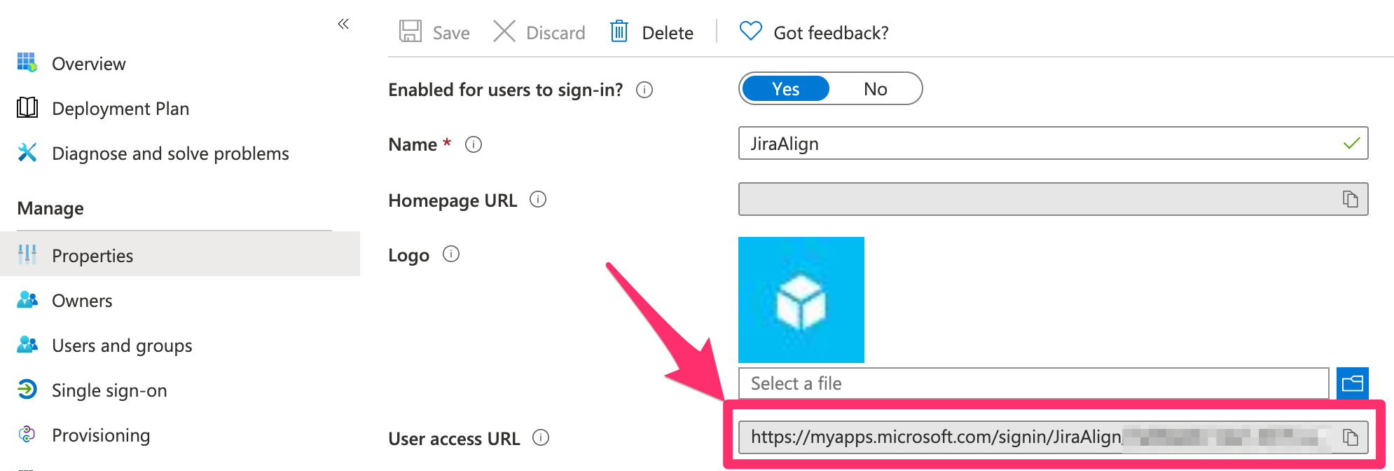

15. In the left hand menu under Manage, click Properties and copy the User Access URL for use in a later step. User Access URL will start with https://myapps.microsoft.com/signin.

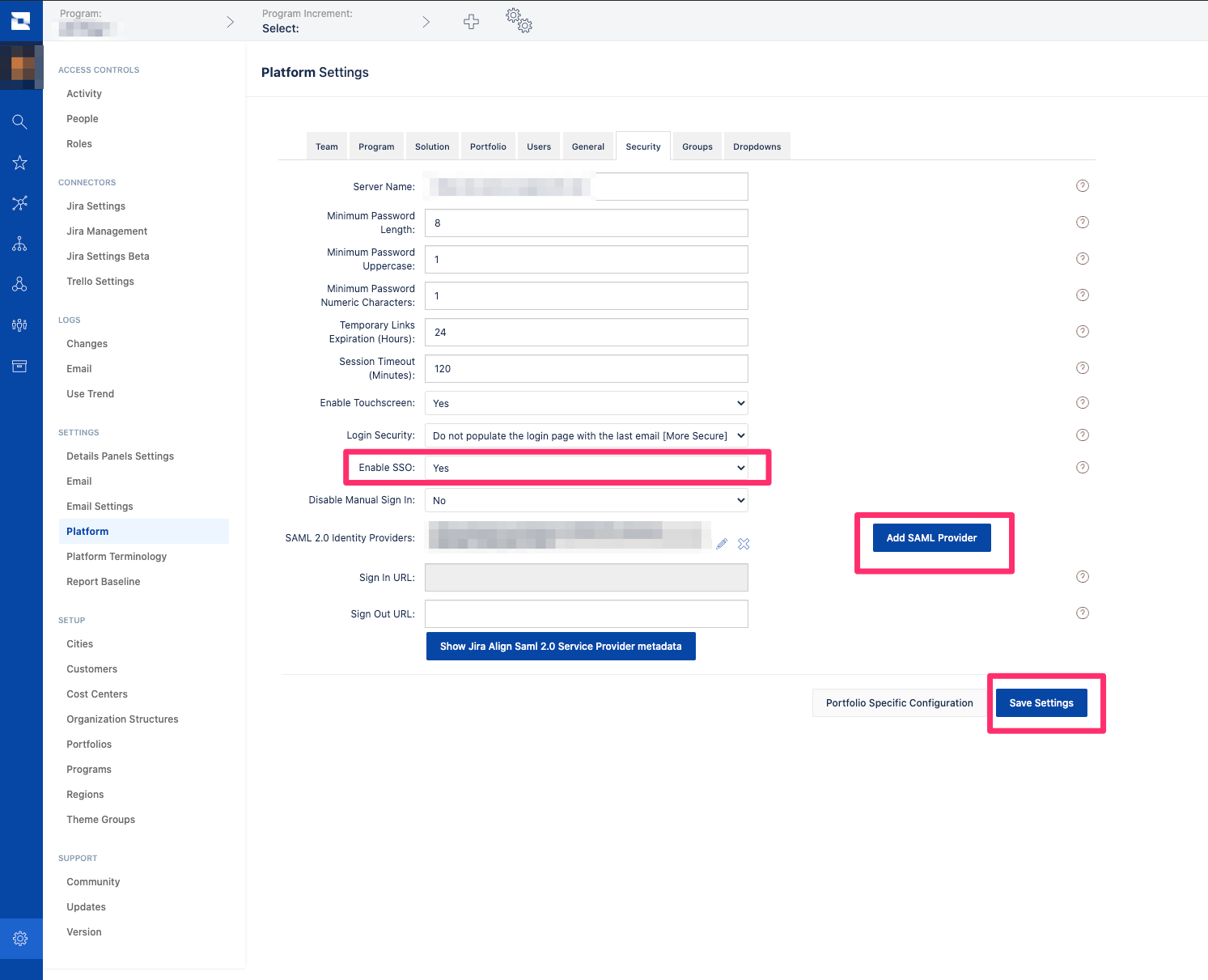

16. Sign into Jira Align and click Administration > Platform > Security.
17. Click Add SAML Provider.
18. Paste in the SAML 2.0 Metadata from Azure (Step 13 from earlier).
19. Click Save & Close.
20. Set Enable SSO to Yes.
21. Click Save Settings.

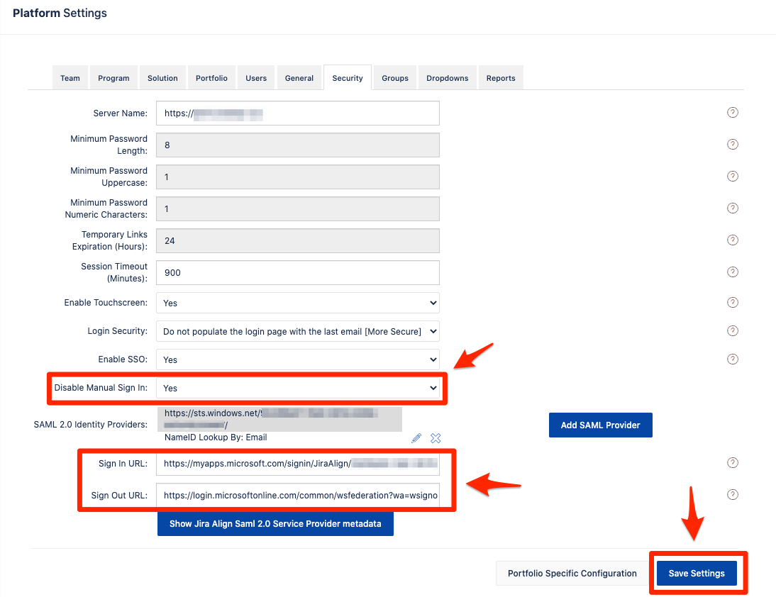

Disable Manual Sign In
- Once you are confident that there are no known issues with SSO, you can go back to Platform Settings from earlier and set Disable Manual Sign In to Yes.
You'll need to open a ticket with Jira Align to regain access if you get locked out while Disable Manual Sign In is turned on.
- After you have set Disable Manual Sign In, you'll be able to fill out the following fields:
- Sign In URL (use the URL from step 15)
- Sign Out URL (use the URL from step 14)
If for some reason your Sign In or Sign Out URL contain encoded characters (Example: %20 for space), you'll need to replace that with the non-encoded equivalent.

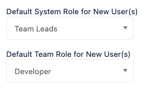

Default Roles
To change the default roles assigned to new users, please navigate in Jira Align to Admin > Connectors > Jira Settings > Jira Setup.
Scroll all the way to the bottom and review the Default System Role for New User(s) and Default Team Role for New User(s).
