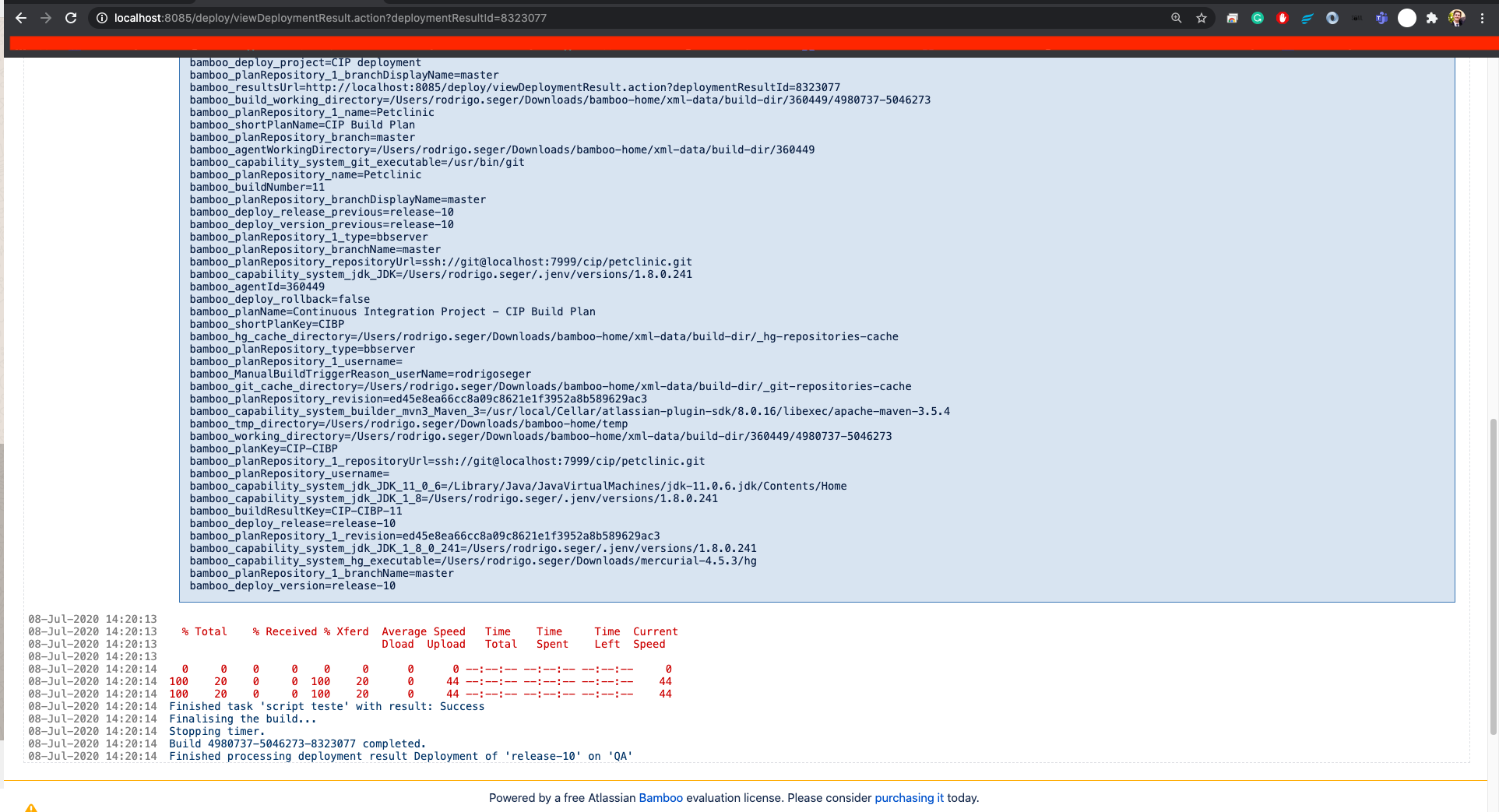

I thought about using the Script task to send the webhook with this information to Jira, but I'm trying to print the variable on the screen as shown in the print below and it is not displayed on the screen but no error message appears.

Log of the last deploy I carried out testing the value of the variable "deploymentState" on the screen.

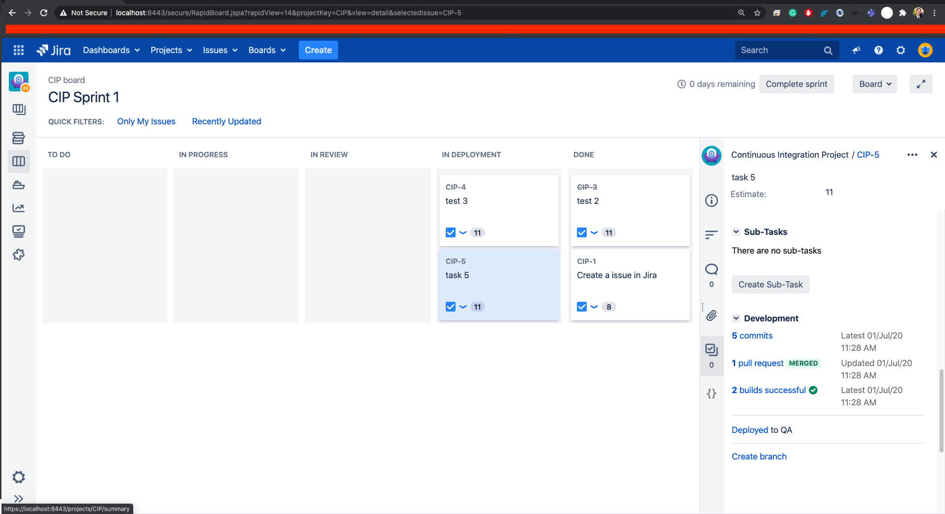

Project board in Jira, where I want to transition the issue from the Build column to Done column.

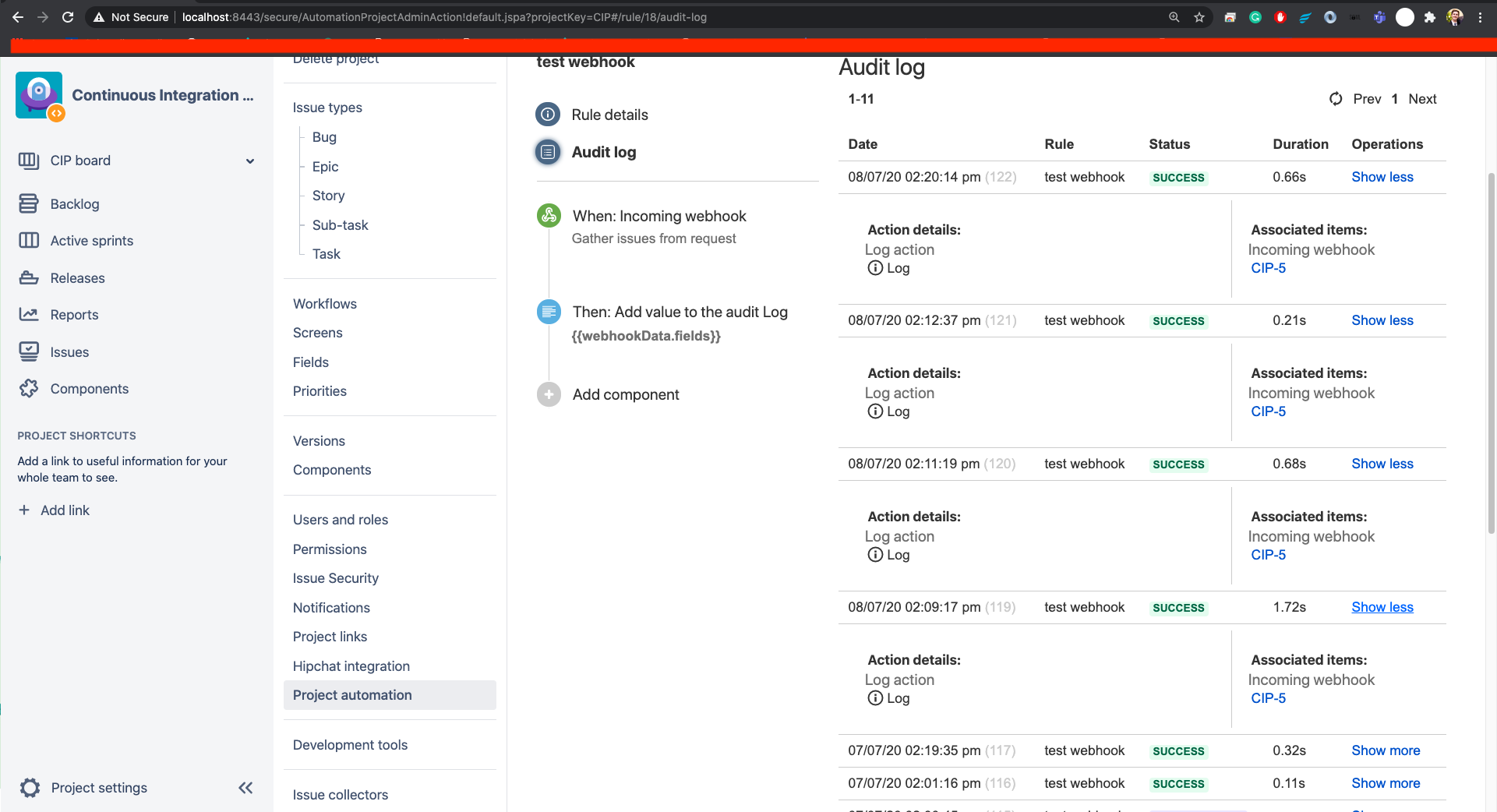

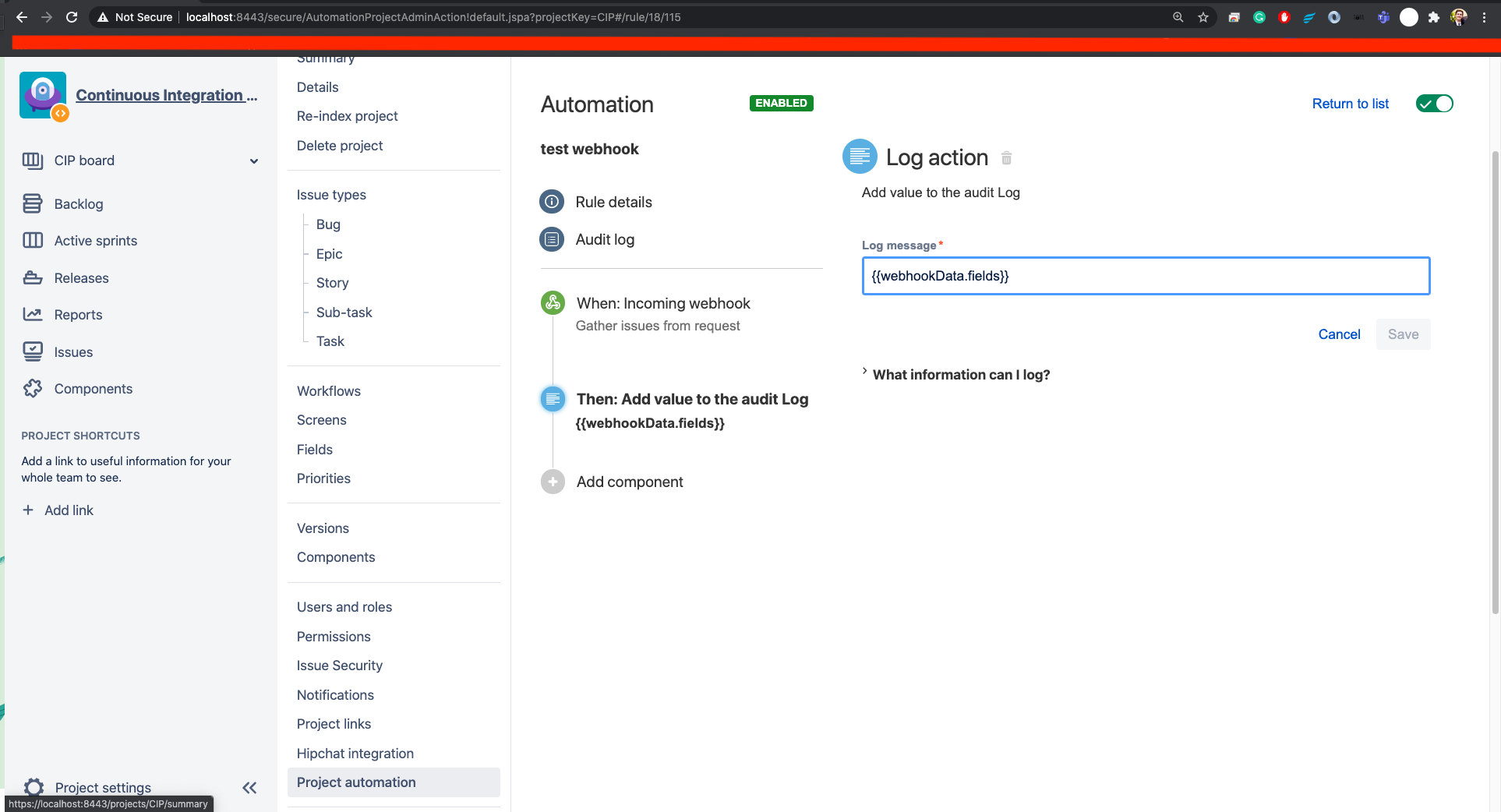

Log of the Automation Rule to check if Bamboo information is arriving correctly in Jira.
Result of the last tests using the automation rule with Webhook.

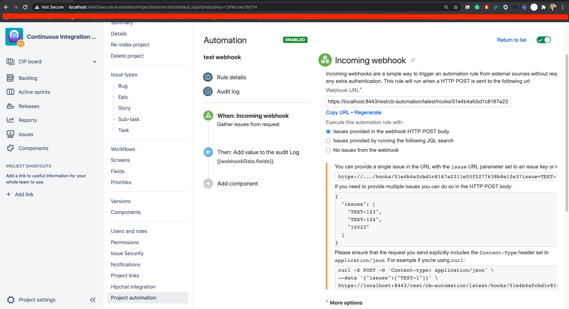

Automation rule being triggered using Webhook.
