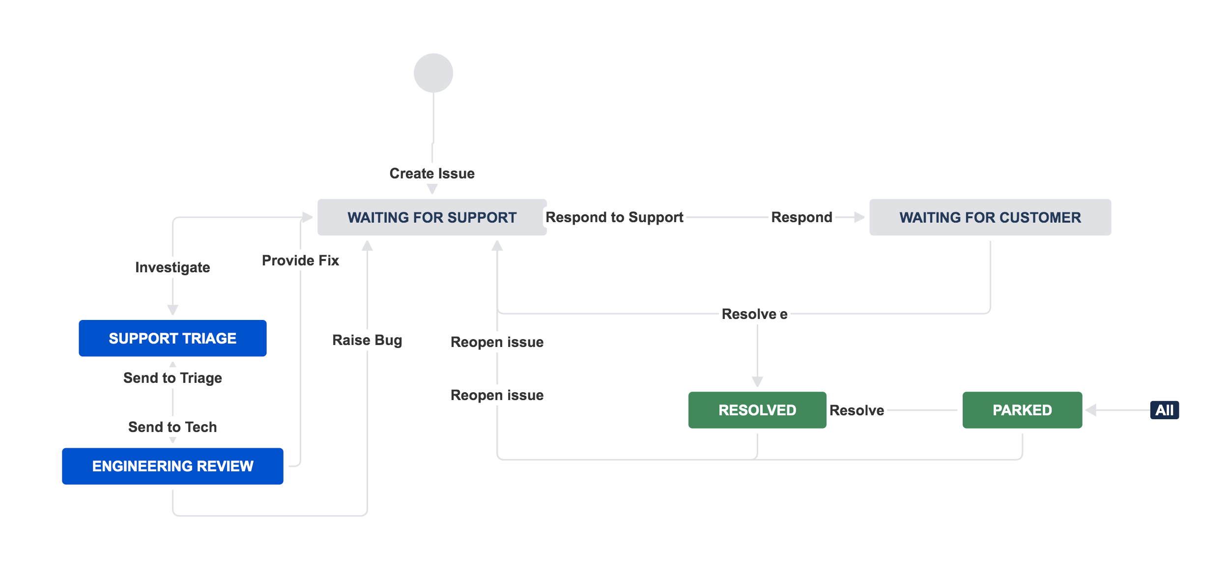

- The Support Agent may suggest some standard solutions, may ask for support files or additional information, and will try to reproduce the problem. Once it’s determined that the customer has indeed found a bug, the Agent will transition the issue to SUPPORT TRIAGE.

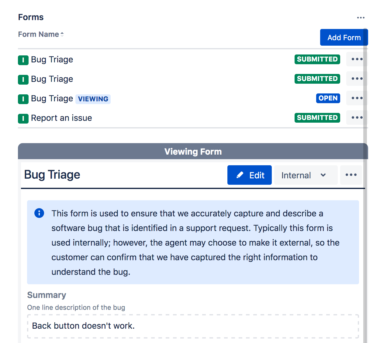

- A Bug Triage form is automatically added to the issue. This form has two sections. The first part is completed by the Support Agent. Along with a description of the problem and the environmental information carried over from the first form, it also collects information about the bug's impact, and the steps needed to reproduce the bug. While this form is designed for internal use, depending on the complexity of the situation the Agent may set the form to external, allowing the customer to confirm that information recorded accurately reflects the bug.
- When the Agent has completed their section of the form, they transitions the issue to ENGINEERING REVIEW. The Engineer completes the second part of the form, providing the Agent with the information needed to explain the findings to the customer.
- The Engineer then transitions the issue, either by providing a fix, or by raising a bug.
- The Agent uses the information Engineering added to the form to update the customer.
- If the Engineer raises a bug, a post function is triggered which uses Deep Clone for Jira to clone the issue into the Development project. The newly created issue includes the Bug Triage form, providing all of the information needed about the bug.

Along with gathering structured information that saves time for the dev team, the biggest advantage we've discovered is standardization – Using a form ensures that the Agent asks the customer all of the relevant questions. Communication between all three parties (customer, Agent and Engineer) is organized around topics rather than just listed chronologically. When we need to refine the process, we can easily add fields to the forms without making any configuration changes.
While this solution works for clearly passing information between the customer, the Agent and the Engineer; and for converting a customer's bug report to an issue in our dev backlog, it does have its limitations. In cases where the customer has reported multiple bugs on the same ticket, we can attach as many Bug Triage forms as needed. However, the forms do not have an identifier. When viewing the issue you have to click into each form to see which bug it's associated with.
