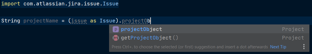

When you create a script there are a number of variables bound to the script but the IDE (IntelliJ) doesn't know about them. e.g. if I create a script field, "issue" is a bound variable
As you can see, "issue" has a dotted line and there is no auto-completion
One way to remedy this is to use "as Issue" everywhere
but that can get cumbersome
