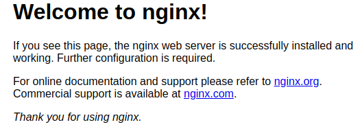

What happens on my https://jira.domain.com

acceptCount="100" disableUploadTimeout="true"/>My nginx.conf is stock and I added jira.conf in the sites-enabled folder of nginx:

}I can access Jira through the debug HTTP connector.
