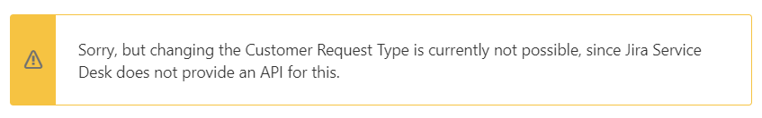

I've looked into using JMWE and 'Automation for Jira', but neither seem to be able to do what I need:
- JMWE - doesn't allow the Request Type to be set (in a post function automation) - it just isn't available in the dropdown.
- 'Automation for Jira' - feeds back a warning:
"Sorry, but changing the Customer Request Type is currently not possible, since Jira Service Desk does not provide an API for this":
I'd really appreciate any help to automate changing the Request Type.
