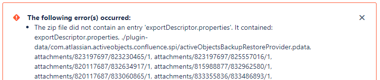

After a few seconds The page is refreshed and I get the following error:
The following error(s) occurred:
As you can see although the error states the file exportDescriptor.properties is missing, it actually does exist in the file.
Unzipping on my win laptop or in Ubuntu also shows the file is existing!
