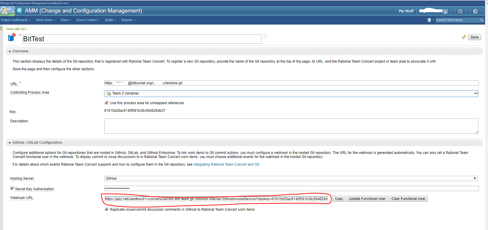

I am trying to configure RTC to use the Bitbucket repository (RTC can integrate with Github)
I am configuring the Bitbucket repository in RTC and from that i am using the webhook url
When i am configuring the Webhook in Bitbucket, i am not having a option to add the authentication details of RTC, I used App password for the same. but didn't work.

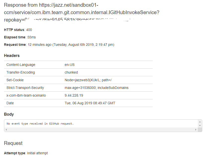

for any trigger event in Bitbucket, i am getting the below error.
