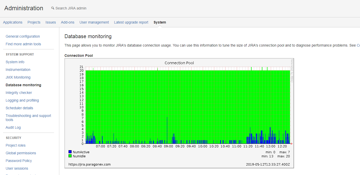

The error message reported in the Jira logs about the connection pool acquired by a thread is not reporting right numbers,
2019-05-12 13:34:33,311 Caesium-1-1 WARN ServiceRunner [c.a.jira.ofbiz.ConnectionPoolHealthSqlInterceptor] Dangerous use of multiple connections: replaced => count=0; marks=[-1-0]; pool=22/20
As you can see in the attached pic the database Monitor shows a max of 7 connections,
Although my log file is full of this warning, and it keeps going every couple of seconds.
I'm not sure what to do, I read that this warning is because my JIRA is suffering from pool exhaustion, but according to the monitor this is not the situation,
Should I stick to the monitor's result or log warnings, What do you guys suggest me to do?
