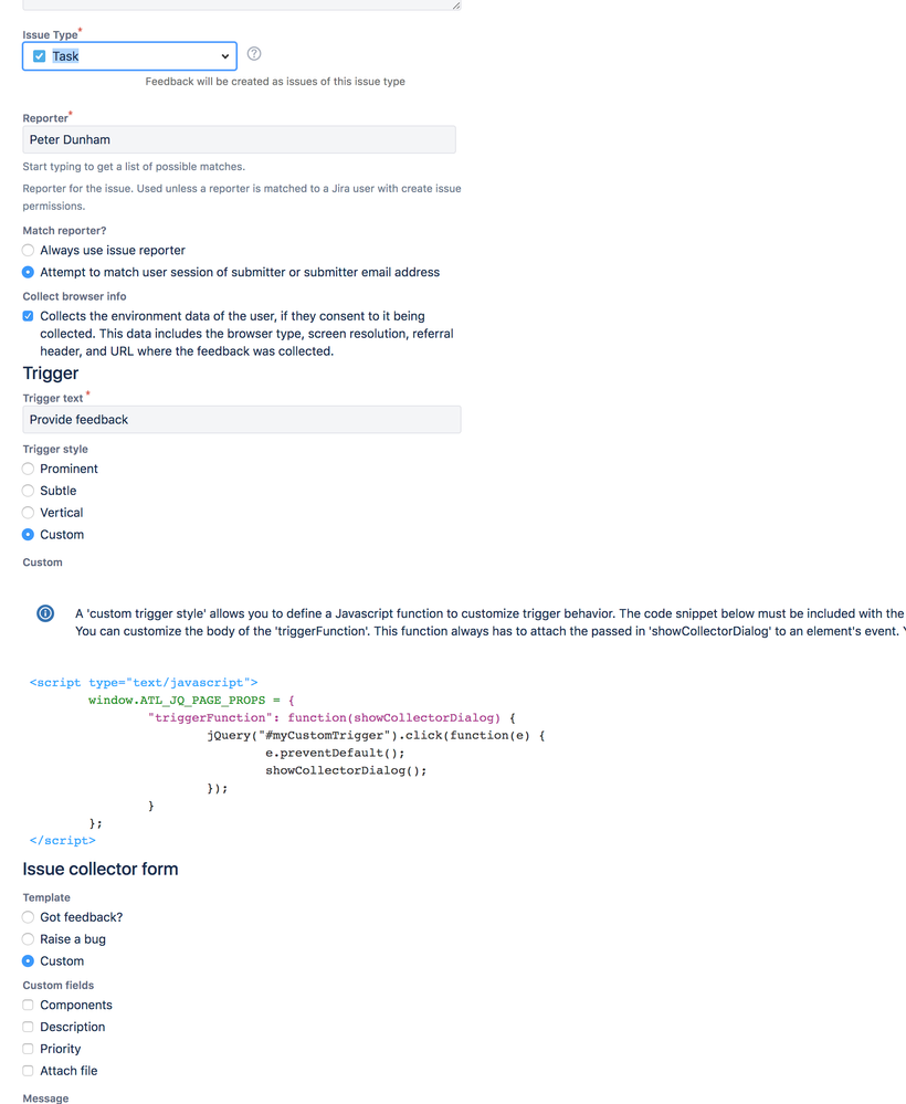

I have included some screenshots below with these details. In a Sandbox project I am collecting against a "Task" issue type. The available fields in the collector are the fields within the Screen.
Here is the collector form below. You can see for a Task that I can add some fields like Description, or Priority. These fields currently exist in my screen (see "Custom Fields" section below):

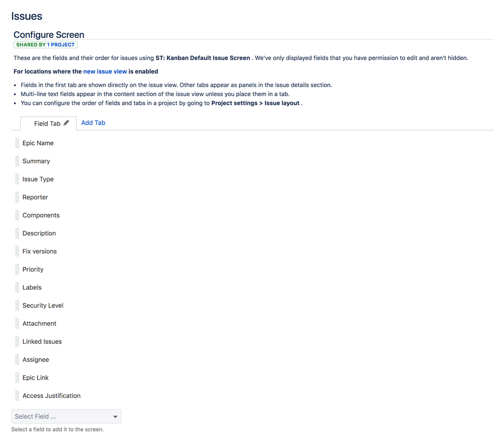

Well, I go to the screen for "Task" as configured in my project.
I add "Access Justification" field which was not there for previous screenshot. This is just a custom field I had in my sandbox, so here "Access Justification" would equal your age, id, or whatever custom field you need etc.

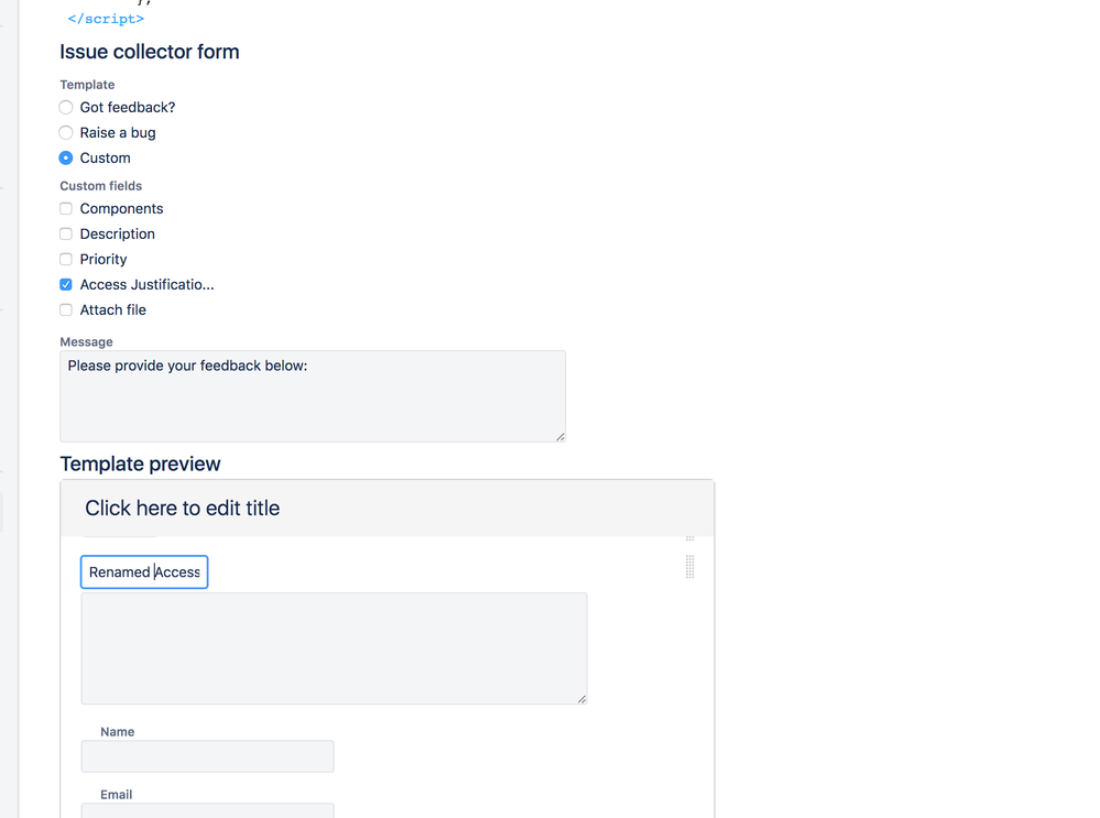

Now, "Access Justification" my new custom field is available within my collector config (had to refresh this config page).
Again, "Access Justification" could really be any field. In the screen shot below you can also see an additional benefit is that I can rename the field on my collector form. So I rename field description to "Rename Access Justification" which will collect into "Access Justification"

Can you tell me why all the fields listed in the issue's configuration screen, like :
- Epic Name
- Summary
- Labels
are not available within the collector config fields list?
In your example, I see 15 fields for your Task but only 5 in the collector config. Why?
Thanks
Yes, I believe this has to do with a Jira quirk whereby we have to explicitly associate a field with a particular project workspace’s field configuration context:
