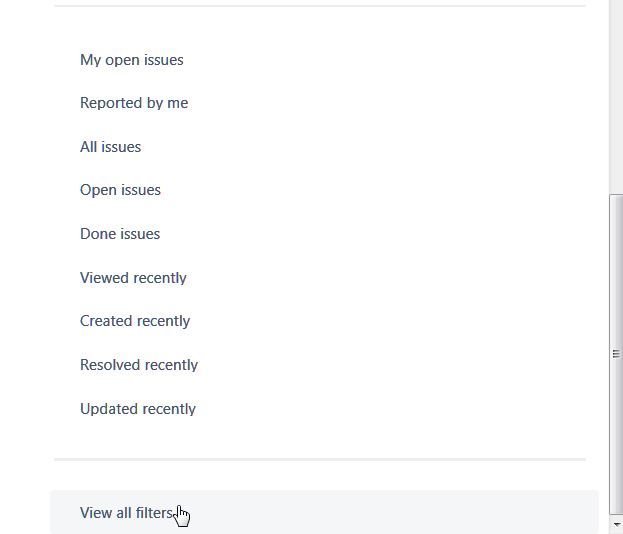

"Manage filters" was moved to "View all filters" in the new UI. After i made a dashboard for my colleagues and share it, i couldn't find it too...
