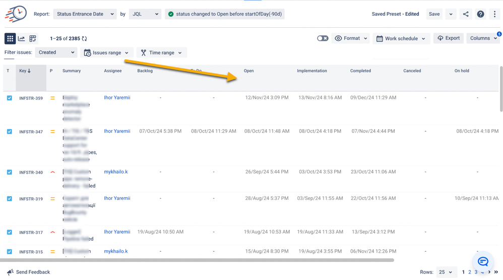

Alternative Solution:
If you are interested in time reports and ope to add-ons, option for you can be Time in Status. To show report when a user story is moved from "To Do" into "in Progress", just:
  1. Choose Status Entrance Date report
  2. Filter by JQL
  3. Filter issues by Data Ranges
  4. Get your data!
You can also book a live session to ask any questions about the add-on. Add-on developed by my team.

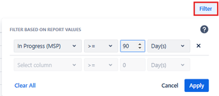

However, JQL has no built-in functions to calculate time spent in statuses. This limitation makes it challenging to generate detailed time-in-status reports without additional tools or workarounds. If you are open to try out a mktplace app for this use case, you can have a look at
Time in Status Reports
With this app you generate time in each workflow status for multiple issues with multiple filter and grouping options. For your specific requirement, the status duration filter allows to filter the issues which are in a particular status with greater than "xx" days.
More details here.

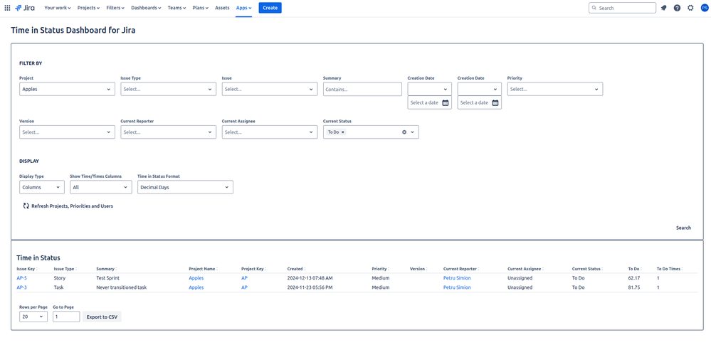

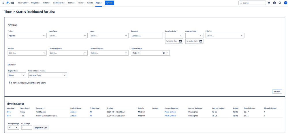

Hi @Digvijay Singh Gehlot ,
One solution is to write a scripted field, assuming you have Script Runner, that will calculate the time the issue spent in the current status, by parsing the history of the issue. Then you write a JQL to return all issues for a specific status where the value of your scripted field is greater than 90 days.
The solution is non trivial and will require a significant time to design, code and test.
You also have to clariy if what to do if the issue was moved out and then back into the status.
If you are open to using apps, you can use Time in Status Dashboard for Jira , an app released by our company.
In a tabular format you can find how long issues have spent in each status and how many times they were in the status. Here is an example for status To Do.
Using the Colums perspective:
Using the Rows perspective:
Regards,
Petru
The table shows you also how many times the issue was in the status.
