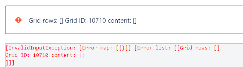

I have a table grid with two columns (column A and column B) and it's initialized with static values (no datasource). The values in column B are set to "Not Validated", but it has a checkbox to enable editing it to "Validated". And my script validator is in the "Validate" transition in the workflow.
So the scenario must be like this: when all values in column B are ticked to "Validated", and when the workflow's transition "Validate" is clicked, it must check whether all values in column B are all "Validated" before the workflow can transition to "Validated" status.
However, I'm encountering a problem with reading the table grid. I'm getting the correct issue and custom field id but it's returning an empty data. So since my validator can't read the grid data, it's not checking anything.
Do you know what might be the issue?

Kristian Walker _Adaptavist_
January 28, 2020
Hi Aira,
Thank you for your question.
I can confirm that the reason that your code above will not work inside of ScriptRunner for Jira Cloud is due to the fact the code you have provided is for ScriptRunner for Jira Server and this will not work as Atlassian only provide a rest API in Jira Cloud and do not provide a Java API in the cloud-like they do in Jira Server.
You can see more detailed information on the differences between the cloud and server versions inside of our documentation page located here.
We would recommend reviewing the documentation for ScriptRunner for Jira Cloud which is located here along with the Jira Cloud Rest API Documentation in order to see how the REST API's work in Jira cloud.
Also, I can confirm that Validators in Jira Cloud are limited to only being able to use the Jira Expression Framework documented by Atlassian here, which means you will need to check if you can validate what you require using this in order to see if your requirement can be achieved using ScriptRunner for Jira Cloud.
Finally, I can confirm that the ScriptRunner for Jira Cloud documentation page located here explains in further details on how to add validators with the plugin.
If you are not using Jira Cloud as you have indicated above then you can ignore this message and I would advise re-tagging this post to show that you are using Jira Server or Jira Data Center so that someone with experience on this can assist yourself.
