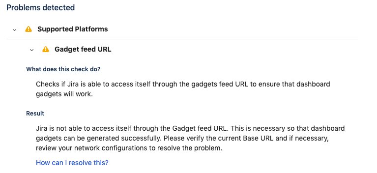

We also saw this health check error:

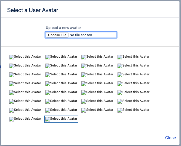

Avatars are also not available:

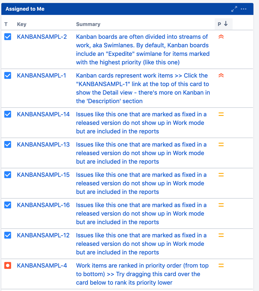

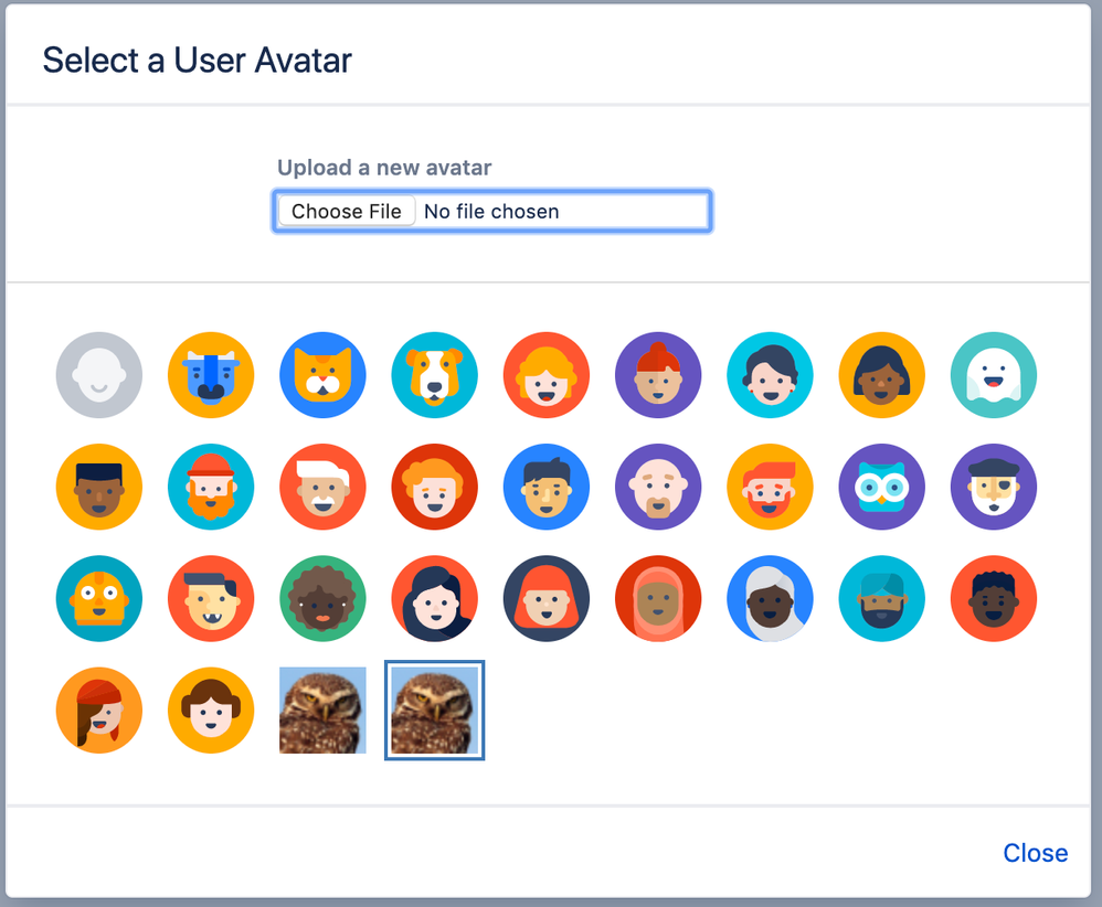

After restarting nginx, everything is working now:
Thanks for your suggestion - it was spot on.
