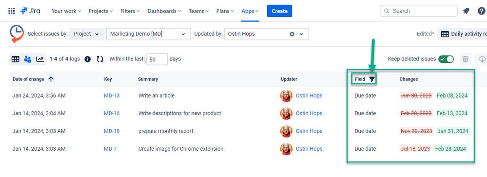

Yuliia_Borivets__SaaSJet_
Atlassian Partner
March 21, 2024
Hi @Andres Zamudio
JQL supports only six fields within history searches (Assignee, Fix Version, Priority, Reporter, Resolution, Status). It doesn't work for custom fields, so you'll need to look for alternative solutions like those suggested in the previous answer.
If you are ok with third-party apps, check the Issue History for Jira (free for 30 days) developed by my team. It provides the info you are looking for. You can check all the changes made to the field "Progress" or any other.
Here is how it looks for the due date field:
More info: How to get history for the specific issue field in Jira
