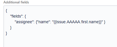

Radek Dostál
October 8, 2024
So you have a multi select, but you're using a json path to a single value. Of course that won't and shouldn't work.
If it's "multiple choices field (select list)" I would imagine it's an option based field, but I hope it really is a multi user picker?
How do you choose which user to pick from the list and how do you handle a scenario where the list is empty?
Consider logging the value you're getting from "{{issue.Responsible.name}}" to see what you're getting.
After that I assume you will need to get a single value from the list like this https://confluence.atlassian.com/automation/jira-smart-values-lists-993924868.html

Radek Dostál
October 8, 2024
Well, just do issue.Responsible.get(0).name as you did - the only difference is the getter by index.
Or issue.Responsible.first.name to make it more "readable".
It does surprise me that it would be empty in your original format though. Purely json-syntax wise it is not a valid getter, but A4J documentation makes it seem that it should return the array of names. Meh, either way.. first.name should work.
EDIT
Oh also, iirc assignee and users should be mapped by keys.
If this still doesn't work can you try a combination of:
assignee: { "key": {{issue.Responsible.first.key}} }
Maybe the docs are confused, or I'm confused, but in any other API it uses keys so I think that might also be a potential thing to look out for.

Radek Dostál
October 8, 2024
Hm, dunno.
These both work though just tried:
or
I'm guessing it's the missing quotes, realized while editing that the smart value returns the "pretty" string without quotes, so you might be probably missing it in your json.
vincenzo.spatafora
October 8, 2024
Thanks again @Radek Dostál.
As before: no errors but the assigneed has NOT changed despite the log says "Issues edited successfully".
