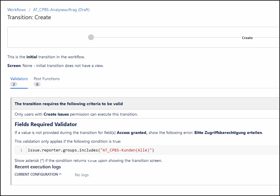

I've a custom field that should be required, if the reporter in usergroup "AT_CPBS-Kunden(Alle)", but it should be mandatory for all other users.
I want to make this in JIRA Workflow with the validator "Fields Required Validator (JMWE app)"
2024-05-15 15_31_54-Transition_ Create - CPB Software AG – Mozilla Firefox.png

Hi @Josef Sigl
You could try
currentUser.isInGroup("AT_CPBS-Kunden(Alle)")

Josef Sigl
May 16, 2024
Thanks so much, It works ;-)

David Fischer
May 15, 2024
Hi @Josef Sigl
your question wasn't entirely clear, you wrote that the custom field that should be required, if the reporter in usergroup "AT_CPBS-Kunden(Alle)", but it should be mandatory for all other users. It sounds like it is mandatory for all users. Did you mean that it should be mandatory only for members of the group, or for all users except members of the group?
If the former, then the conditional validation script should be:
Otherwise, it should be:
! currentUser.isInGroup("AT_CPBS-Kunden(Alle)")
