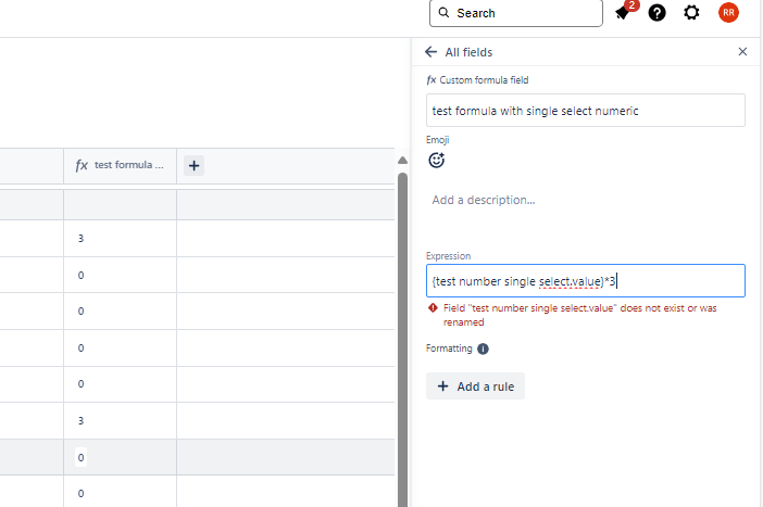

I'm looking to create a formular made up of a number of custom fields. Each custom field is a selected value 1,3,5,8,13. In my final formula these are all recognized as "1" so in both the roll up and the custom formula, adding three fields together, no matter their selected value = 3

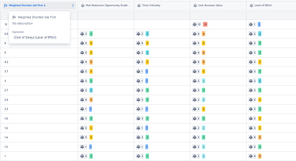

Update:
Wasn't sure if it was better to answer here or edit my original question but I ended up 1. adding weights to the single-select options that equal the "number value" I was looking for and then 2. simplifying the equation by creating a separate roll-up value for the fields I was adding together. I'm uncertain if the second piece was necessary but it worked so I moved on. Will test out your answer @Bill Sheboy for posterity! Here is a screenshot of what I have working now. The final formula is shown in column 1, the "cost of delay" is a sum of the next three columns.

I was unable to add the {{#=}} nor the ".value" to my formula. Is it possible I need to find the custom field ID somewhere, or that Jira Product Discover has different syntax? See screenshot where I get the wrong value (7*3=3), and subsequent one where the formula is invalid when adding ".value"incorrect value.pnginvalid expression.png

As you are doing the calculation in a JPD custom formula for a field you only need to use the field name for the calculation.  For example:
{test number single select} * 3
Ryan Rayfield
March 1, 2024
Right so check out the first screenshot - so i get “3” instead of “21” when the {test number single select} =7
this was the initial problem I encountered.

Ended up just using the custom select type and adding a specific weight as mentioned in my edit for the post above. This way I was able to keep the selection limited to the numbers I wanted to present and have the formula pick up the integers (the weights) properly!
