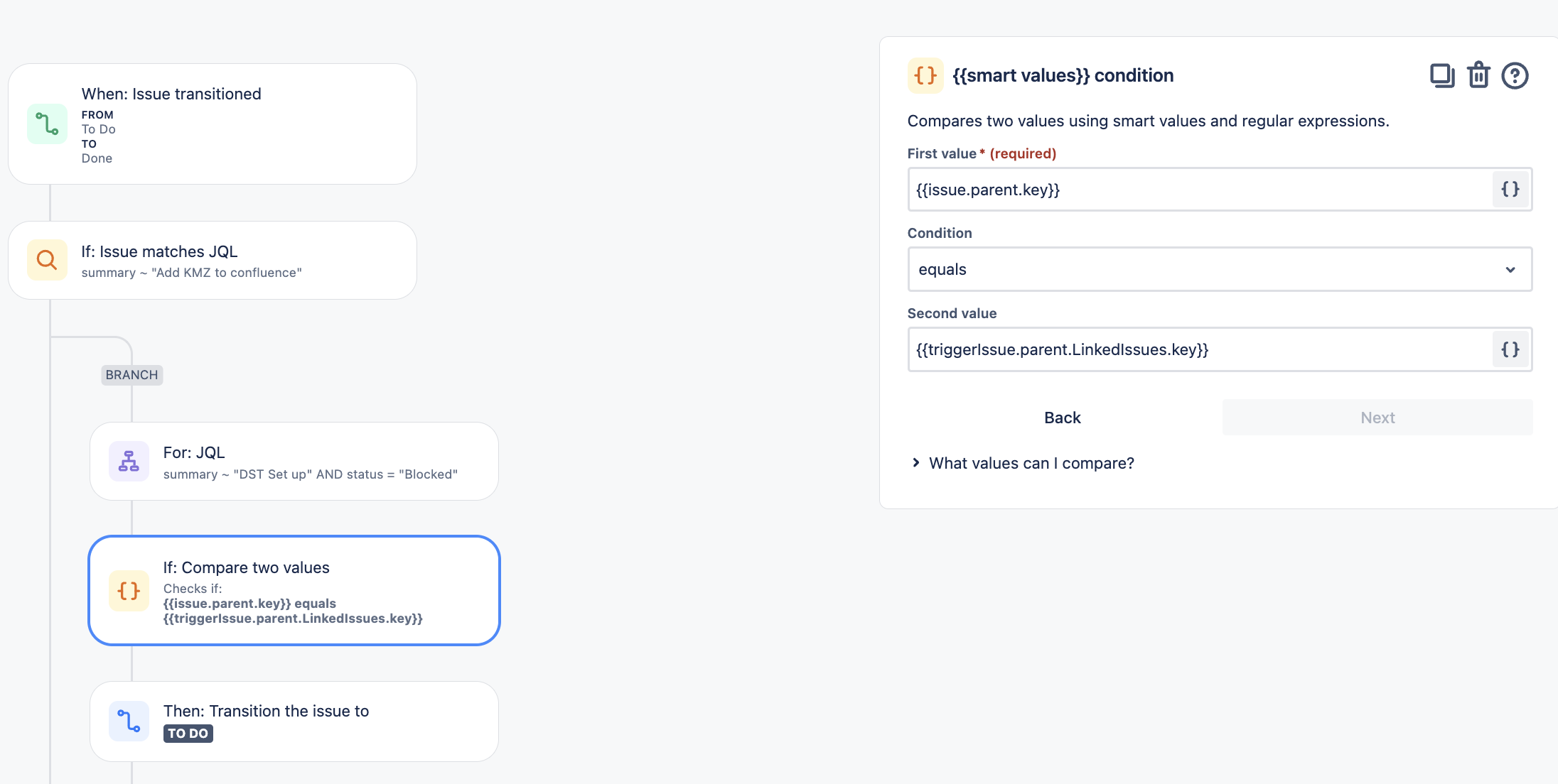

Hey all,

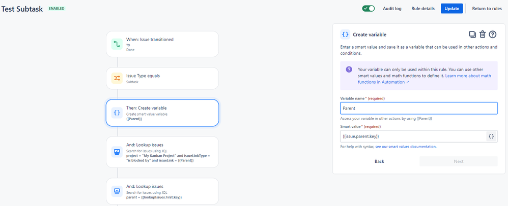

I am looking to make a rule that:
when a subtask #1 is marked as done, then change the status of the subtask #2 to to do.
The problem is that subtask #1 is the child of task #1, subtask #2 is the child of task #2 and these tasks (1 & 2) are linked.
I have been trying to pursue this by using this code, but it isn't working. I wonder if you have any suggestions. Thank you so much in advance!!
P.S. Apparently what isn't working is the smart values condition :/

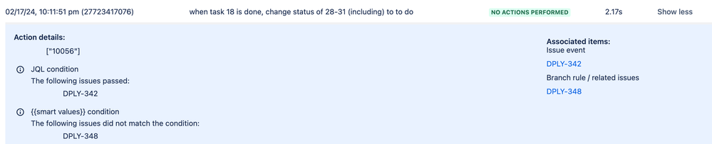

Hello @Martina
What are the details in the Audit Log for the execution of this rule?
Where did you get the idea that this was a valid smart value?
{{triggerIssue.parent.LinkedIssues.key}}
How are tasks 1 and 2 linked? What type of link is used? Can task 1 have more than one other task linked to it using the same link relationship that is used for task 2?
This is a fairly complex indirect relationship that you are trying to follow. Have you considered instead creating a directly link between subtask 1 and subtask 2?
Do you have any third party apps that extend the capabilities of JQL, such as ScriptRunner Enhanced Search or JQL Search Extensions?
2. I invented it, I know the bold part works: {{triggerIssue.parent.LinkedIssues.key}}, I also tried: {{triggerIssue.parent.issuelinks.key}} but it doesn't work either.
3. Tasks 1 and 2 are associated using the normal link. Yes, task 1 can have more than one task similar to 2, linked to it.

2. You can't "invent" smart values. ;-) You can use only valid smart values. And what you have attempted to use is not valid. You can find more information about what are valid smart values for an issue type of object here:

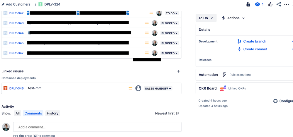

How can I add a dependency between subtasks?
Task #1 is DPLY-324 while Task #2 is DPLY-346
Thank you!

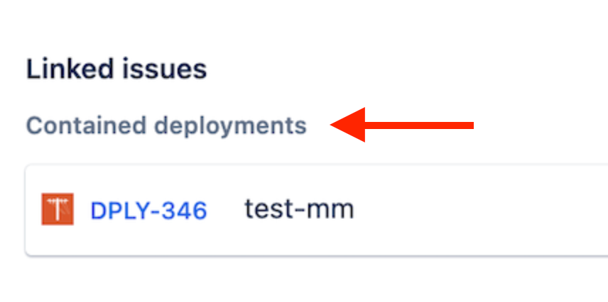

Is the parent Task of subtask #1 always going to be linked to the parent Task of subtask #2 with the "Contained Deployment" relationship?
I said "add a depedency", but in more general terms I mean link the two subtasks together directly using a unique link type that you can rely on in this rule to tell you which destination subtask(s) (the subtask 2's) need to be changes when the source subtasks (the subtask 1's) have been updated.
You did not indicate with your post tags if you are an admin for your instance. It would be very helpful to us to know the types of links available on your instance.

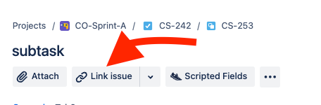

Trudy P Claspill
February 20, 2024
You would use the generic issue linking functionality:
When you click that button you should see something like this:
In the pull down list you choose the type of relationship. In the field on the right you enter the issue key for the other subtask.
The options available in the pull down list are customizable by your Jira Administrators, so we don't know what options are available in your instance.

Back to your current setup and automation rule, it would be helpful to get details of all steps to really understand what's going on.
The "for" branch looks weird. What are you trying to do here? Will that JQL always only return one issue? Are you not simply trying to get to the Issues parent or are you trying to get the other Subtask?
LookupIssues and LinkedIssues are Lists. If you are certain they contain only one issue in your case, you can access the first element (which will be of Type "Issue") by get(0) or "First" so accessing the first Element's key in LinkedIssues of the Triggerissue should look like:
Triggerissue.LinkedIssues.get(0).key or Triggerissue.LinkedIssues.First.key
Check out Jira smart values - lists | Cloud automation Cloud | Atlassian Support

subtask #1 is the one in the first if function, and subtask #2 is the one in the for function. There will be more than 1 subtask #2 associated to that subtask #1 since there are more than one tasks #2 associated to only one task #1. I was trying to filter all of the subtasks (they contain that summary) that are associated to the subtask #1 that changed status. I mentioned 'blocked' too because this rule will change them from 'blocked' to 'to do'. Hopefully this isn't confusing.

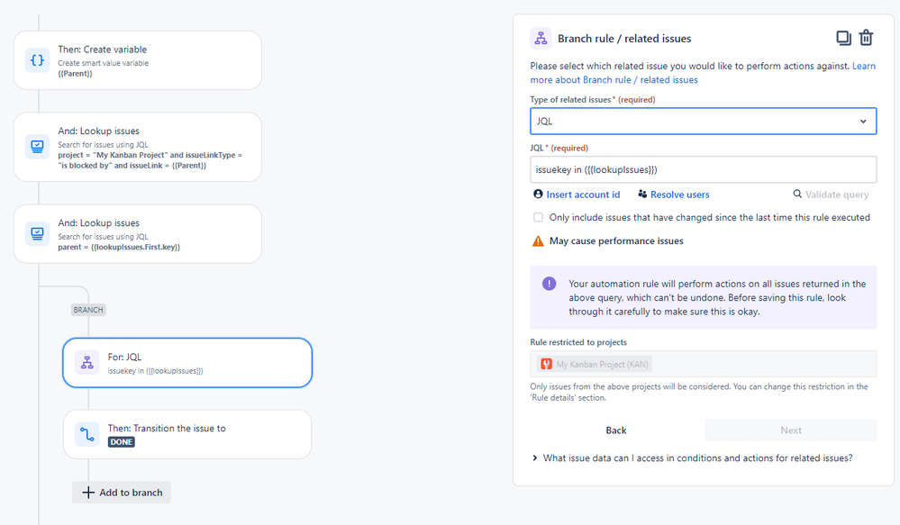

Rebekka Heilmann _viadee_
February 21, 2024
@Martina
Against all other advice (which still is, to link the Subtasks directly per "Blocks" Link Type - description provided by others) I managed to create a rule to achieve what you asked.
Assuming that what you said in the last comment is true 100% of the time:
1. Trigger and conditions need to be adjusted to your needs. TriggerIssue is the Subtask #1
2. Get the issues parent
3. Lookup the Linked Issue Task #2 -> they need to be linked by a specific LinkType. If you don't use the "is blocked by" you need to edit that part
4. Lookup the Subtasks of the first Issue (assuming this would always be Task #2)
5. Branch over all Subtasks (you need the "Related Issues" branch type, not the Advanced one)
6. transition the issues (or edit or do whatever)
Again: Recommendation would be to link the Subtasks directly. You can reuse parts of the first Lookup for reference on how to get linked issues
