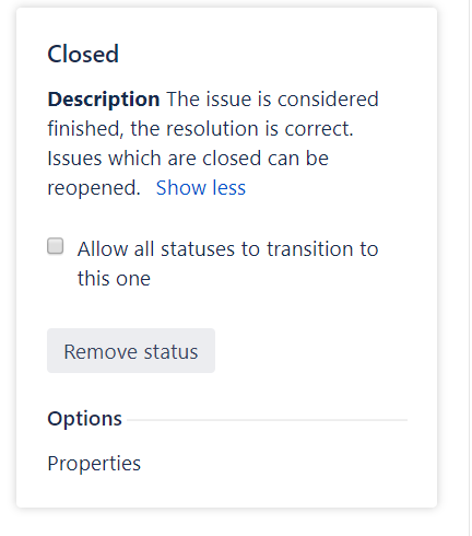

I tried to update the "closed" status properties, but it seems that I don't have the proper permissions. Please see the screen shot below.
Does this mean that I need to ask the admins to make this change?
Best,
 -Noam
Nich Hogue
December 30, 2019
Hello, @Noam Guttman
Yes in that case you would have to ask your admin to make the change and they should be able to make the adjustment they fits best.
Hope this helps
-Nich

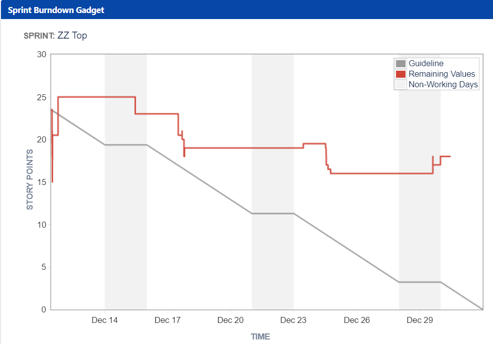

Thanks for replying. I mainly would like to give the team members an option to update the actual story points they required in order to resolve the ticket, in case they closed it without updating the points.
I use it mainly for the burn-down chart and for statistical analysis of the tickets.
