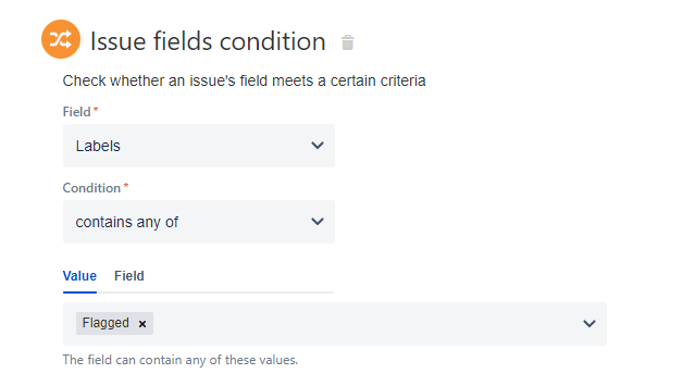

My problem is when I try to used the two automation rules together without adding manually the label "Flagged" into my task A. If I put my subtask B to done, then my task A is updated with the label, but my Subtask C is not.
Audit log says it triggers the label update, but issue A is not matching the condition :
When I check on my issue A, I can find the right label updated by the automation 1:
Do you know why these 2 rules can't work together ?
Could you help me please?

Hi @Garn - By default rules will not daisy chain.  However, on your second rule you can navigate to Rule Details and at the bottom check the box next to:
Check to allow other rule actions to trigger this rule. Only enable this if you need this rule to execute in response to another rule.

Thank you Mark!
