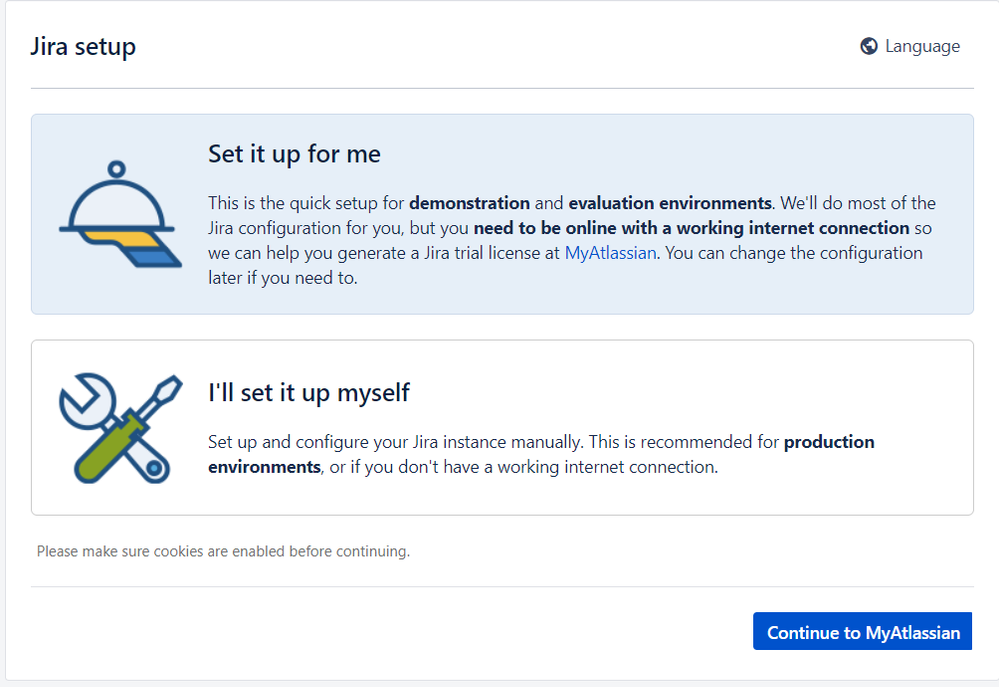

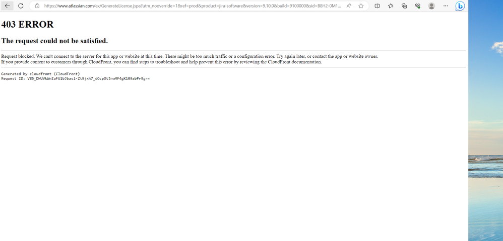

Hi
After installing JIRA and during set up, click on continue to MyAtlassian giving an error.
14 answers
3 votes
bmcalary
August 1, 2023
UPDATE 25/1/25: Jira Cloud now uses AWS Cloudfront. AWS Cloudfront blocks GET requests with a Body payload. See  https://docs.aws.amazon.com/AmazonCloudFront/latest/DeveloperGuide/RequestAndResponseBehaviorCustomOrigin.html#RequestCustom-get-body  Most commonly we see API clients and integrations sending {} [] "" '' . Please ensure your API client does not include a body with a GET request. This information only applies to API clients and integrations, not browsers.
Hello,
Ben from the Atlassian Networking Team.
We believe this was caused by a over-zealous web application firewall rule.
We believe we have fixed the problem. Can you please retry and let us know?
If it's still not working, can you please give us the "Request ID" printed at the bottom of the screen?
Ben.
swara.s
August 2, 2023
I am facing the same issue.
This is the request id:
fbuUABXEduTvLP1DvVpnzjdbKd-JxrsosE2ZsmirUBM1MAEJMzrUTA==
Error: Request blocked. We can't connect to the server for this app or website at this time. There might be too much traffic or a configuration error. Try again later, or contact the app or website owner.
If you provide content to customers through CloudFront, you can find steps to troubleshoot and help prevent this error by reviewing the CloudFront documentation.
bmcalary
August 2, 2023
@swara.s Please try again. :)
swara.s
August 2, 2023
Yes, now its working.
Thanks sir :)

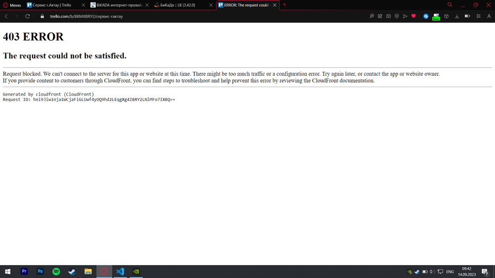

Madenietov Alisher
September 18, 2023
hello, she is working with me in office, url this
https://trello.com/b/8BMX8RY2/сервис-гактау
and in sometimes we have 403 error
The request cloud not be satisfied, this problems started 5 days ago and have now
bmcalary
September 18, 2023
Thanks @Madenietov Alisher we're looking into this now. I'll keep you updated.
bmcalary
September 21, 2023
@Madenietov Alisher @Abdenova Asel we're made some changes. Can you access the product now?
