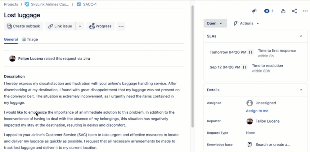

In the image below, you can see ChatGPT filling in the Sentiment, Service, and Sentiment Reason fields automatically:

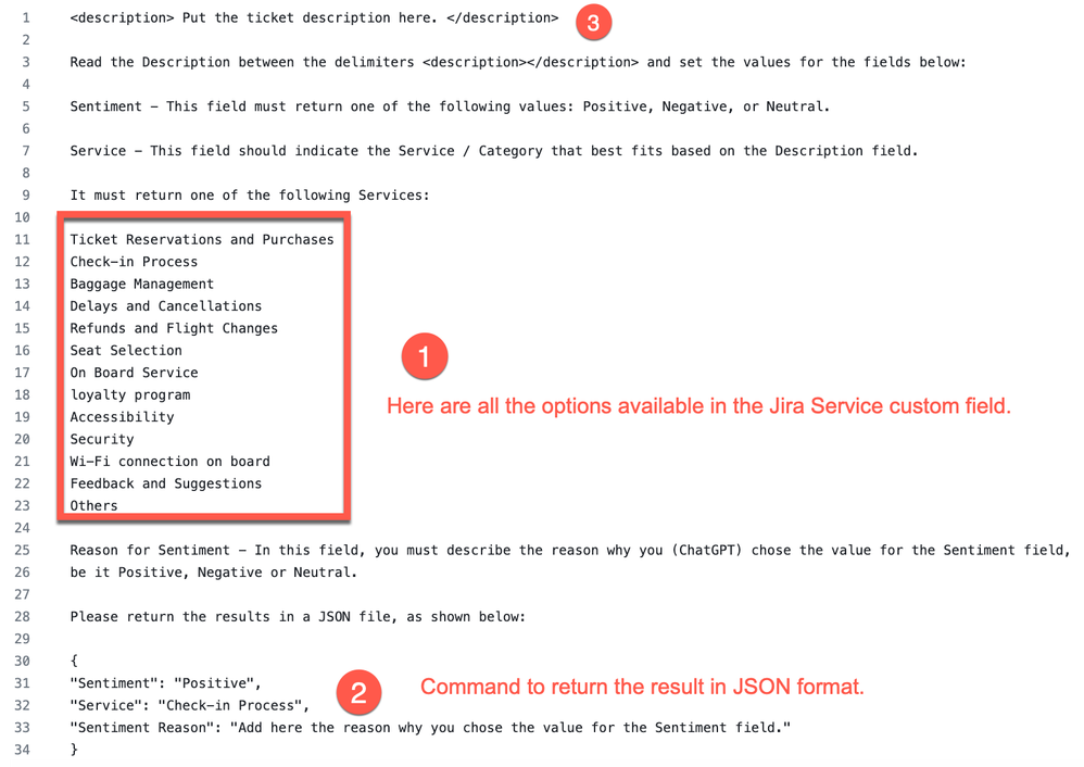

šŸ’¬ Prompt to triage sentiment analysis of Jira tickets
Now that we know what the requirements are for our automatic ticket triage, it's time to create a prompt in ChatGPT that answers all these questions. For this purpose, we will use the prompt below:
The prompt above is clear about its purpose, but I've highlighted three important sections of the image above. Are they:

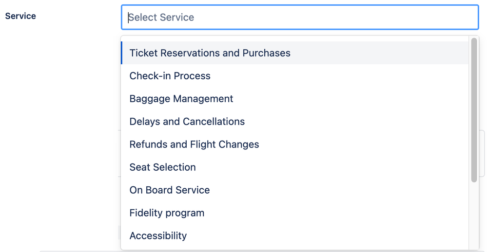

  1. I put all available options in the Service field of my Jira project to ensure that ChatGPT always selects a valid option in Jira.
  2. I requested that the result be returned in JSON format to save with requests for queries in the ChatGPT API.
  3. I made it clear that ChatGPT must consider the ticket description that is between the <description></description> delimiters.

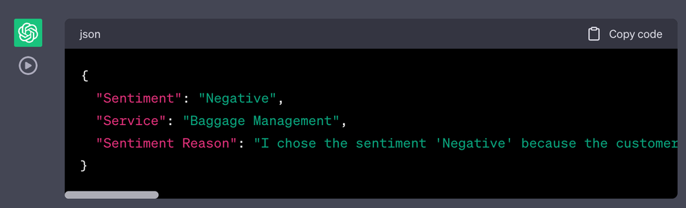

When running a real case directly in the ChatGPT console, I get a response like the one below:
āœ… You can see this prompt in the GitHub repository at this link: https://bit.ly/ticket-triage-prompt-in-jira

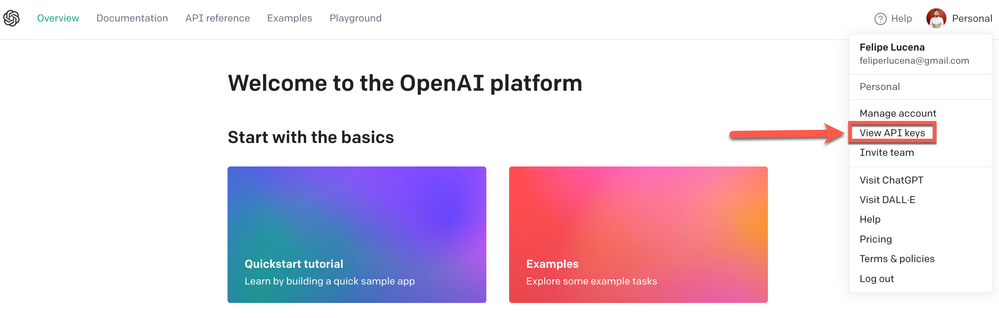

The first thing you need to connect with the OpenAI API is an authentication token, and you can do that by following the steps below:
  1. Go to OpenAI's official website: https://openai.com/
  2. Create an account (if you don't already have one).
  3. Then, authenticate with your username on the Platform page, click on your username (upper right corner), and go to the option View API Keys:
openai_view_keys.png      4. This page will display all the keys associated with your account. In this step, click on ā€œCreate new secret keyā€ to create a new API key.
ā„¹ļø Note: It is worth noting that using the ChatGPT API has associated costs. When creating an API key, you will likely be taken to a payment page to enter your credit card information. OpenAI offers a $5 bonus for new users to try out the API as an incentive.

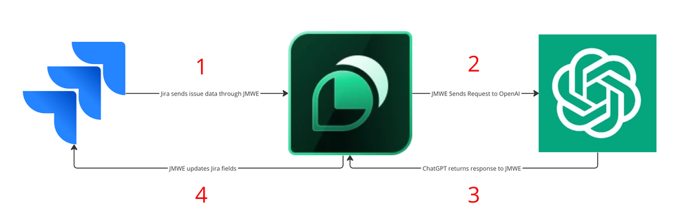

Jira's integration with OpenAI (ChatGPT) was done by JMWE through the architecture below:
Below you can see a step-by-step on how to perform the integration described above:

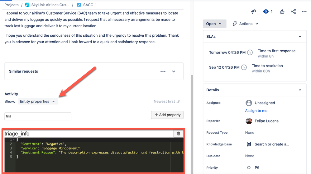

When this post-function is ready, and you place it in a transition in your project's Workflow, Jira will generate an Issue Property like the image below whenever the transition is executed:
This Entity Property is a JSON with all the information we need to fill in the Sentiment, Service (Category), and Sentiment Reason fields. šŸ˜‰
