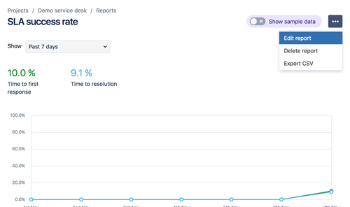

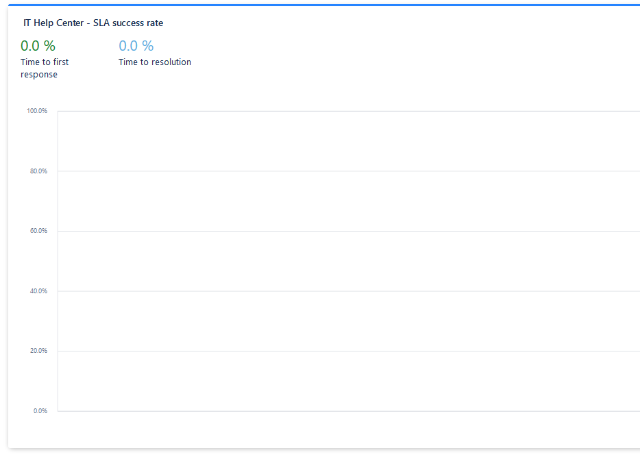

I have setup a couple of basic SLA's, however, the dashboard widgets "SLA Success Rate" or "SLA met vs breached" will not populate (they are empty)

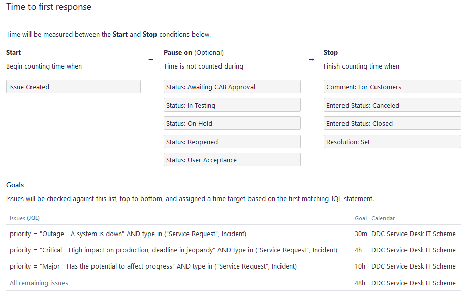

I have attached picture of one of the SLA definitions we are testing:
And this is what the dashboard widget looks like:

Checking the screenshots you provided, your SLAs and issues are properly configured to display in the SLA report, so I believe your SLA Success Rate Report must be configured with some JQL filter that might be excluding the issues from the chart.
Please, follow the steps below in order to troubleshoot it:
- Navigate to your SD project > Reports > SLA Success Rate > Click to edit it:

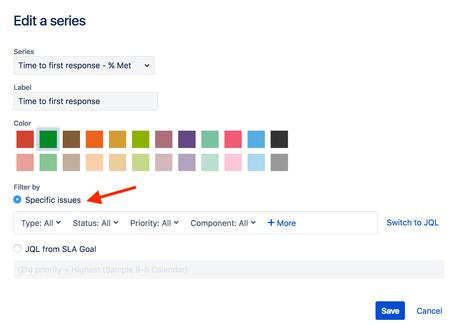

- Click to Edit the series you currently have in your report and check if there is a filter applied to it that might be not considering the issues applied to your SLAs. In fact, clear up the filters and check if the issues are displayed to you:
Let us know if this information helps.

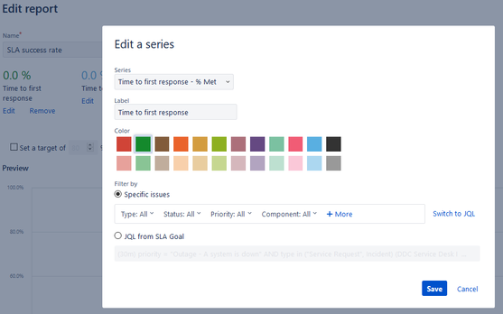

Ok,
below you will see the Filter by that I am using, as you can see I am not filtering out any issues:

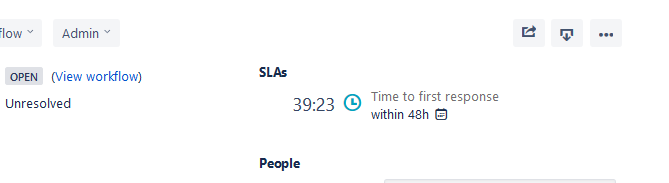

Yes, I have about 50 tickets with a value in the time to first response. all opened in the last 7 days. See example below:image.png

Hi,
Do you have any where the time to first response has completed? Use jql "Time to first response" = completed().  Because if it's still running, I don't think that report will pick it up.
Susan

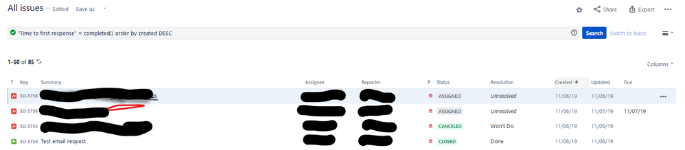

eford
November 7, 2019
yes, 85, here you go:

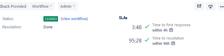

And here is an example of the display in an individual ticket:

However, did the completion of the time to respond happen in the last 7 days.
Try expanding your report out to months and see what you get.
eford
November 7, 2019
The ticket detail I showed in the 2nd screenshot was created and resolved yesterday. However, I opened up the timeframe to "Past Year by Week" and everything is still blank.
