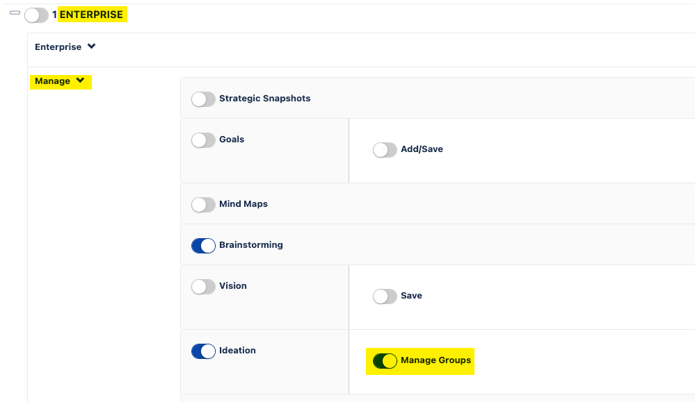

@Tee Bee Just as an FYI, you don't need to be a Super Admin to "Manage Ideation Forms", however you do have to have 2 things:
  • The Logged in Users Role must have the "Manage Groups" option toggled on in the Enterprise --> Manage --> Ideation --> Manage Groups (see screenshot 1 below).
    • This provides the Role the "rights" to be able to manage both the forms and Ideation Groups.

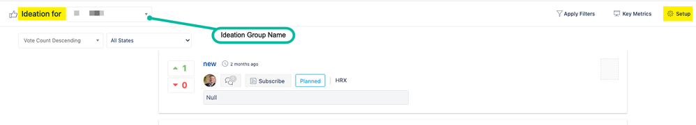

    • Without this, the user would not have the "Set-up" option inside Ideation (screenshot 2)

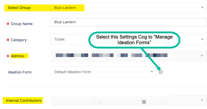

  • The Logged in User must be either an Administrator or Internal Contributor inside the given Ideation Group (see screenshot 3 below)
    • This provides the individual person access to a given Ideation Group (or groups).
    • Without this the user would not have the "Ideation Group Name" to select (screenshot 2)
Screenshot 1:
Screenshot 2:
Screenshot 3:
