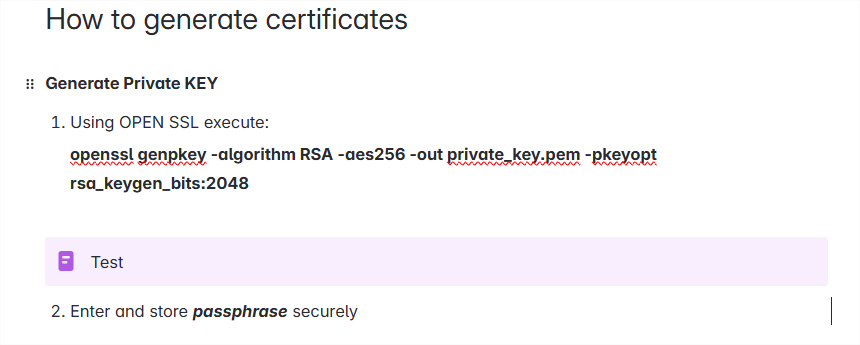

Giuseppe D'Amico
May 16, 2025
Not sure if it works on all versions, but what did the trick for me was to use SHIFT+Enter Key on a numbered line. A new line is added without breaking the list
Giuseppe D'Amico
May 16, 2025
