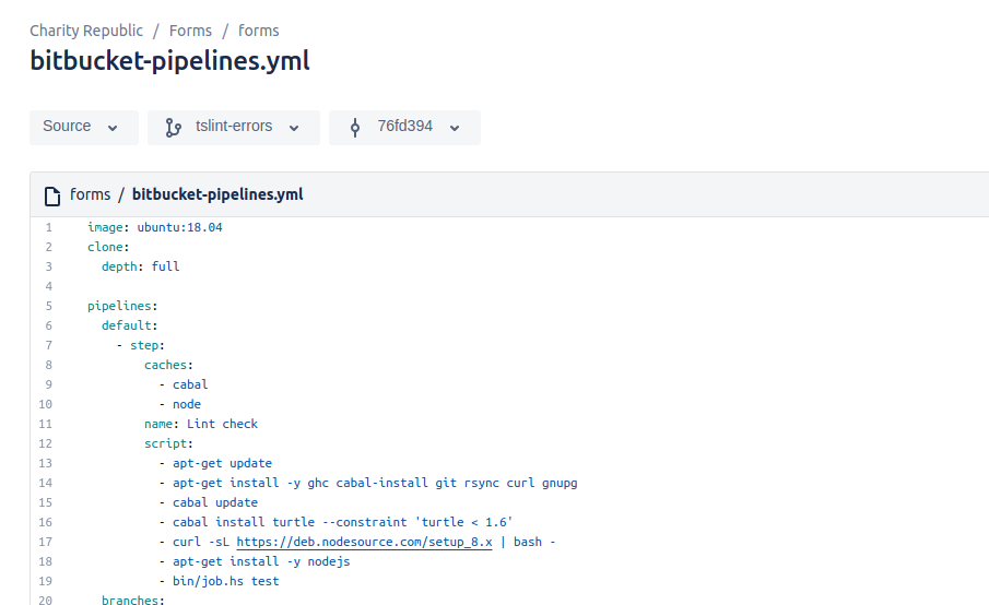

liamcmcdermott
September 18, 2018
I tried adding a clone depth of full, but still got the same error. Presumably this only gets all commits for the current branch?
My `bitbucket-pipelines.yml`:

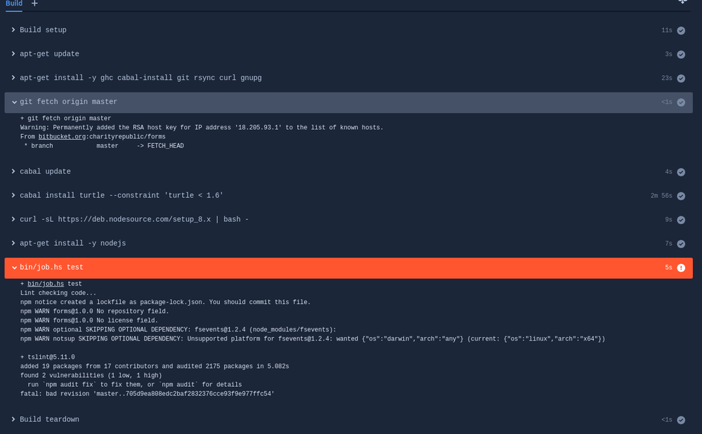

liamcmcdermott
September 19, 2018
Tried adding `git fetch origin master` to the script part of the pipeline (clone depth is also set to full) and got the same error message. The git fetch seems to work fine, so I'm confused.
That commit should be available too, since it's the commit that triggered the pipeline.
Matt Ryall
September 19, 2018
Hmm, yeah maybe a full clone is only for a single branch. You can see the command in the build setup section. I haven’t had a chance to play with this myself yet.
And your fetch should work. But fetching should also show some download activity in the log, so your output looks a bit unusual.
I’ll need to find someone else to take a look at this as I’m out for a few days now. Thanks for your patience.

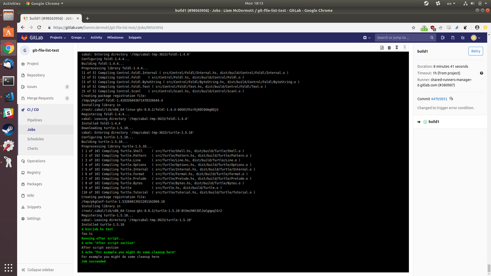

liamcmcdermott
September 17, 2018
I set this same script up on Gitlab, the only difference being the "tslint" was changed to "echo". And it works, see screenshot below where it prints `foo.ts`.
So I'm assuming this is a bug in Bitbucket and the only current solution is, use something else (like Gitlab).
