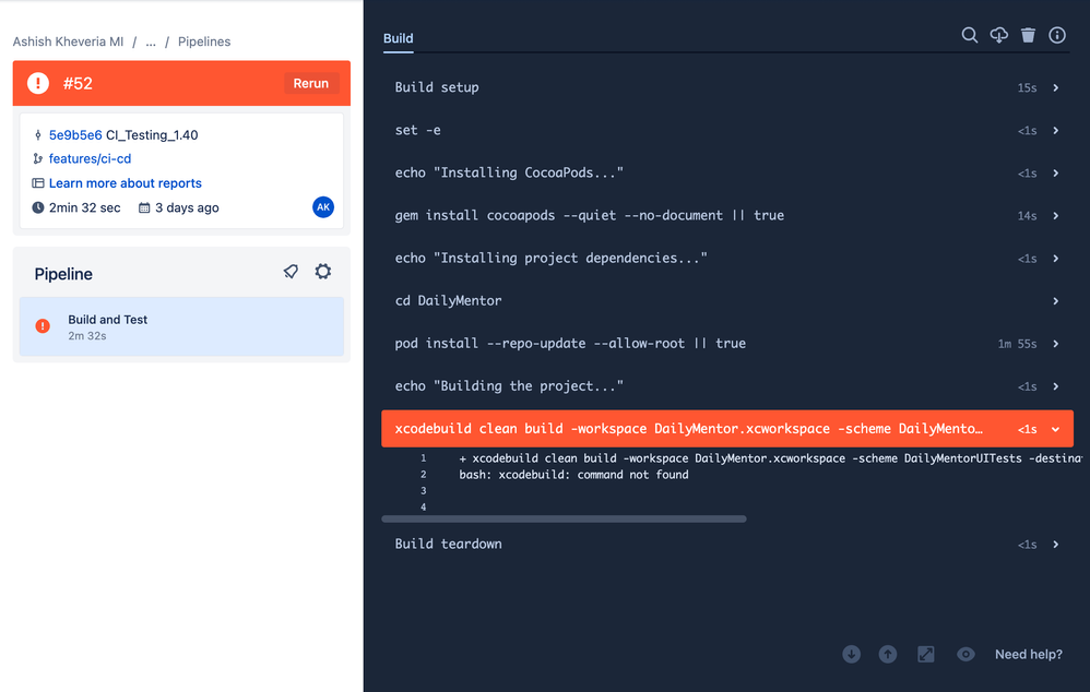

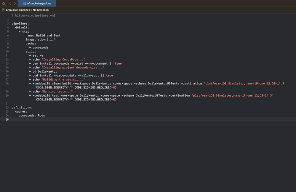

Unfortunately, I am still facing the same issue. Posting screenshots that might help you to understand where I am failing at:
1. yml file: It started failing from line 18, i.e. xcodebuild clean... command
2. Output that I can see on bitbucket pipeline console:
As I said earlier, I had already committed and can see xcodebuild at the same level directory level where in my installing my pods.

Hi @Akash Ashok Kondekar,
Thank you for the info.
I can see from both screenshots that you are running this Pipelines build on our own infrastructure. You mentioned in the title iOS pipeline, so I thought you were using a MacOS Runner (this is why I was talking about MacOS Runners in my previous post).
Pipelines that run in Atlassian's infrastructure currently run on a Kubernetes cluster of Linux Docker hosts. I believe that it is not possible to run xcodebuild on a computer that is not a MacOS, so I don't think you'll be able to run this build on our own infrastructure.
If you have a MacOS that you can use to run builds, you can set up a MacOS runner on that machine and run builds there:
The builds will run on your MacOS, but you'll still be able to view the logs on the Bitbucket website on the Pipelines page of the repo. Additionally, you won’t be charged for the build minutes used by your self-hosted runner.

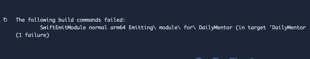

Despite implementing the above steps, we still encounter the same error: ie. " BUILD FAILED The following build commands failed: SwiftEmitModule normal arm64 Emitting\ module\ for\ DailyMentor (in target 'DailyMentor' from project 'DailyMentor') (1 failure)"
PFA screenshots
I am not sure now what I am missing here.

Yes, we are now using MacOS runners. We tried without runner first and there we were getting the "Xcode command not found" error. Then as you mentioned a guided setup for the runner was, we did try that and after that, we are now started getting this issue.
