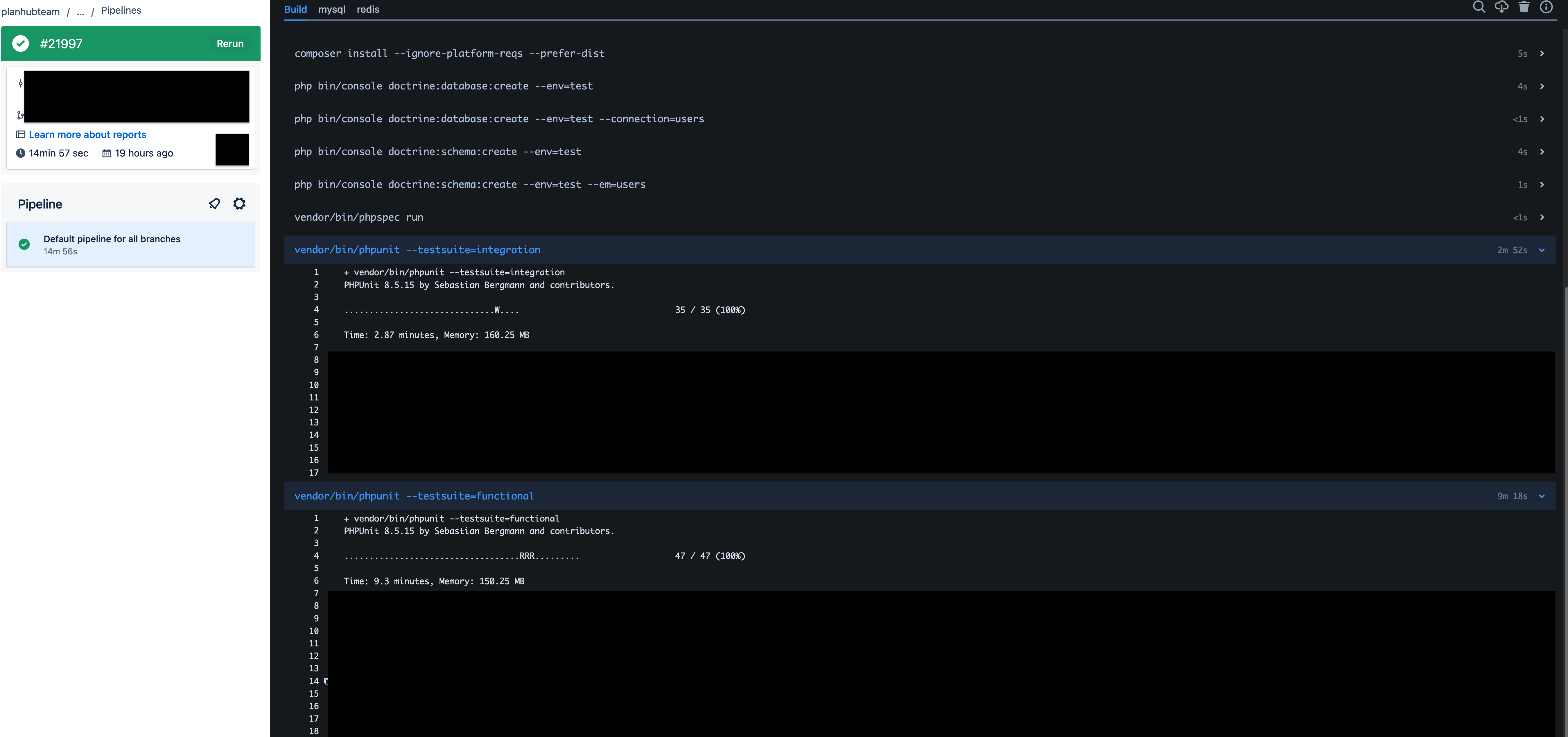

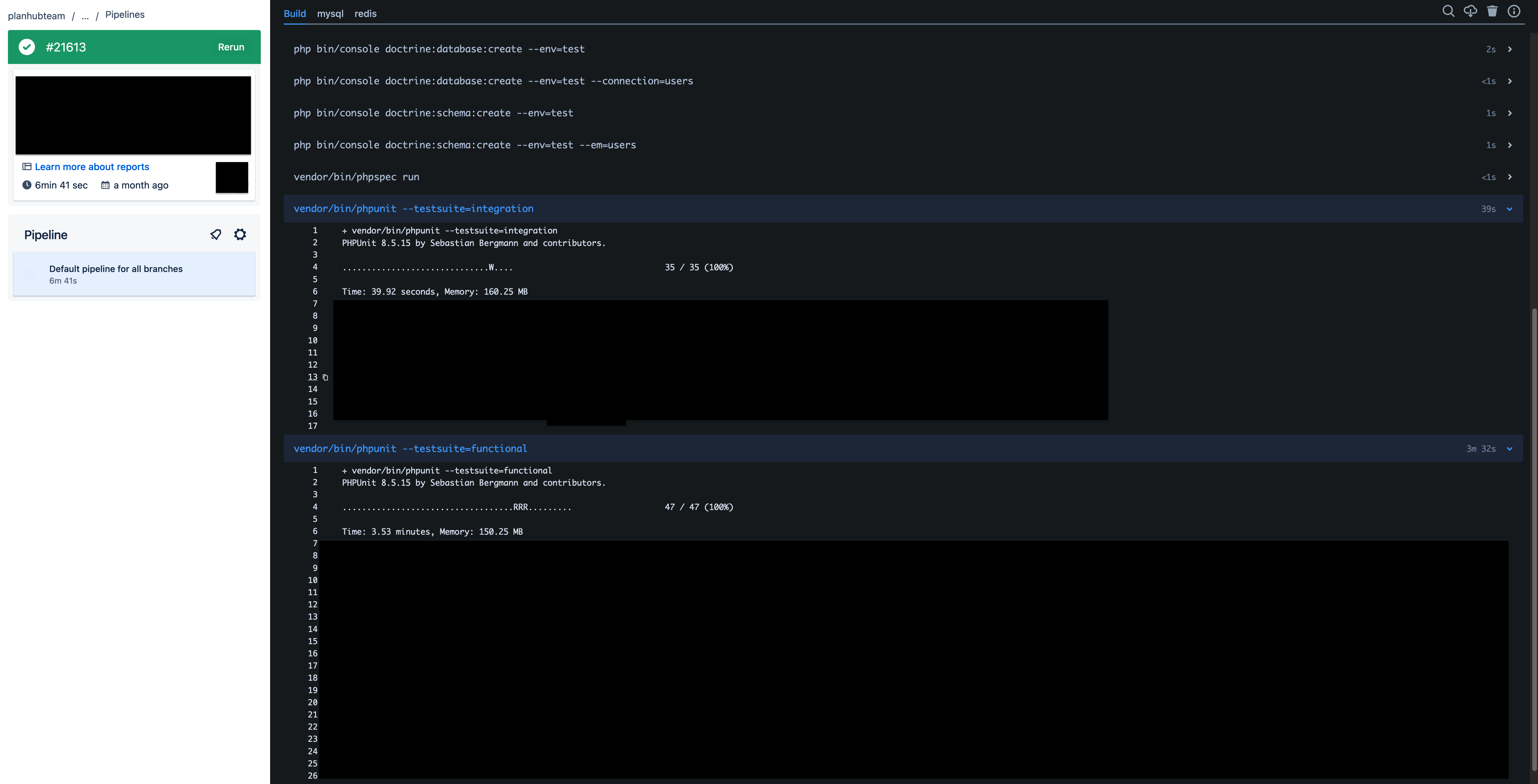

Since around November 18th, we have noticed a significant increase in the duration of our Bitbucket pipelines. Previously, our tests consistently ran in under 10 minutes, but since that date, they now exceed 10 minutes without any modifications on our end.
Our pipeline before November 18th
Same pipeline now
Did you notice the same thing on your builds? What could cause that?

I reran the pipeline on the same commit and it went from 6 min 34sec to 12 min 22 sec
