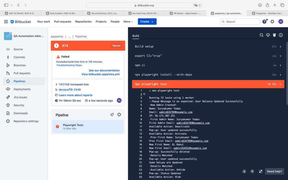

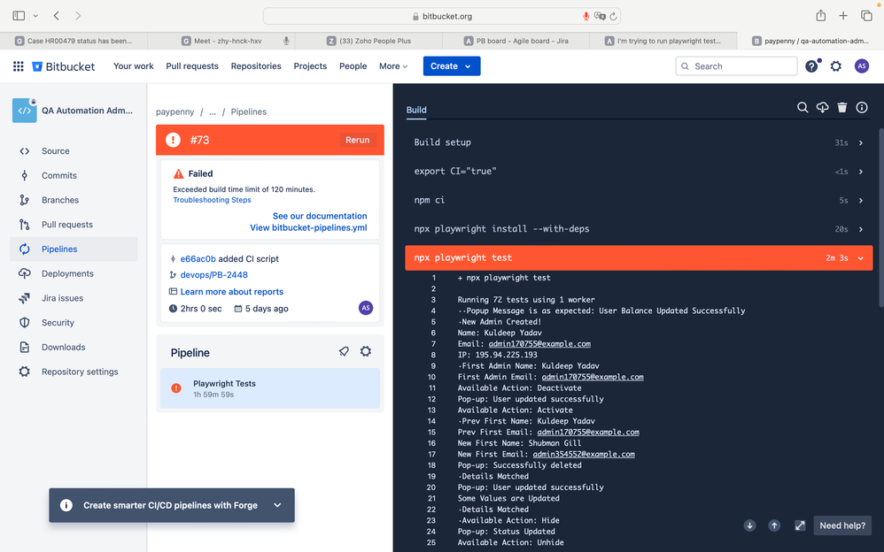

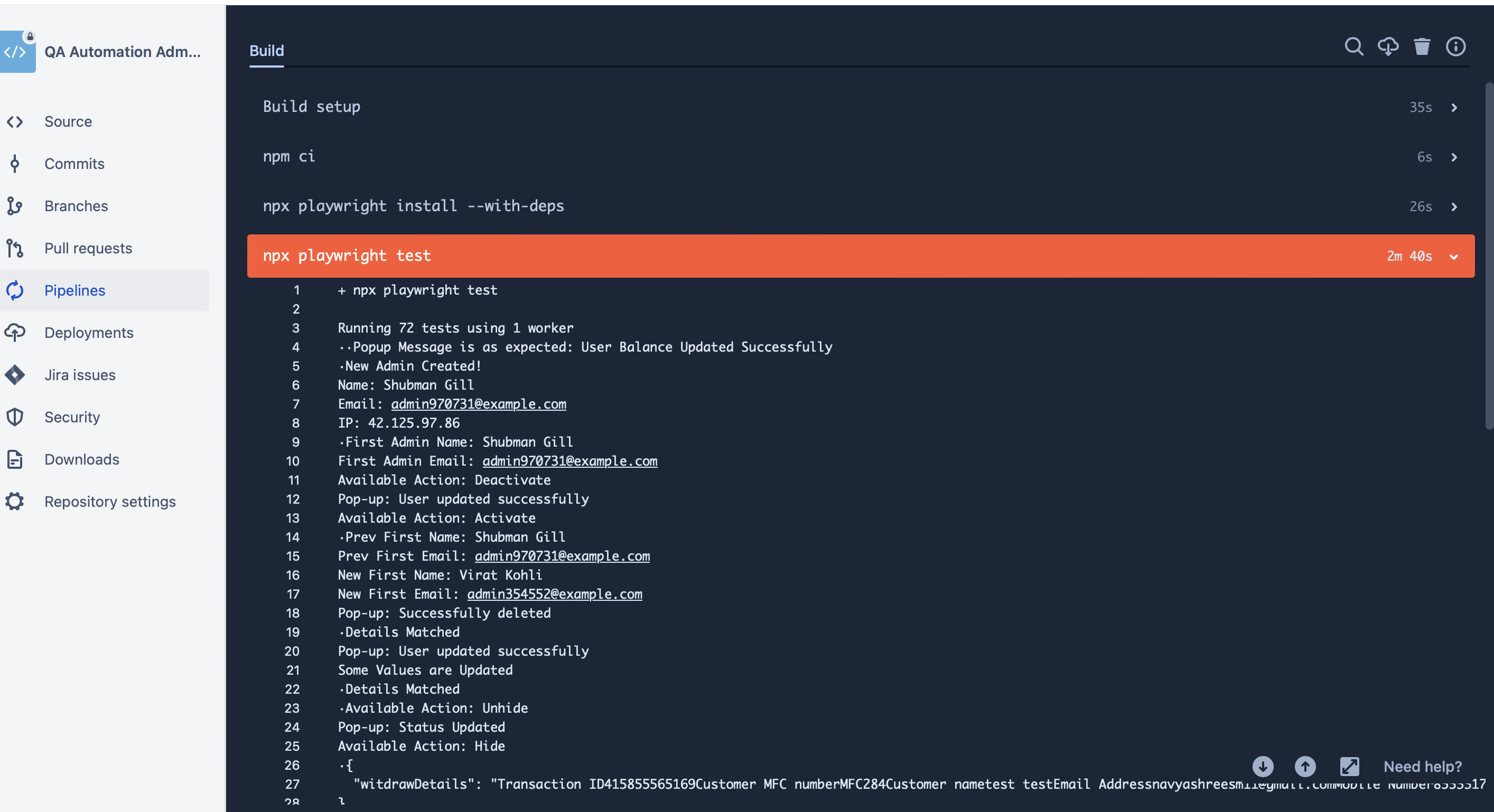

We are trying to configure, playwright browser tests on Bitbucket Pipeline as code is in same repo of Bitbucket.
While running it on local with below commands its working fine and reports are also getting generated. In total 72 tests are running and report is generated.
Below are the commands:
- npm ci
- npx playwright install --with-deps
- npx playwright test
- npx playwright show-report
Whereas if I tried to run the same script using Bitbucket yaml file its getting stuck at - npx playwright test and after 2 to 3 tests it is getting stuck and then logs are also getting stuck, after 2 hours build is showing Exceeded build time limit of 120 minutes error.

Ill be attaching Screenshots of Bitbucket pipeline for reference.
Please help me on this, I got stuck here from a while.

Ameer sohail
April 22, 2024

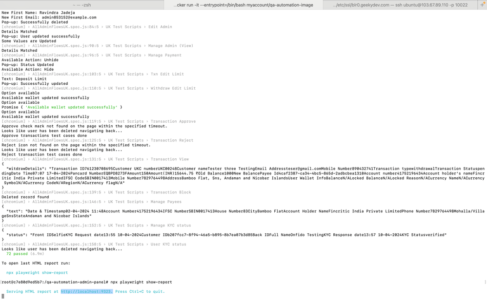

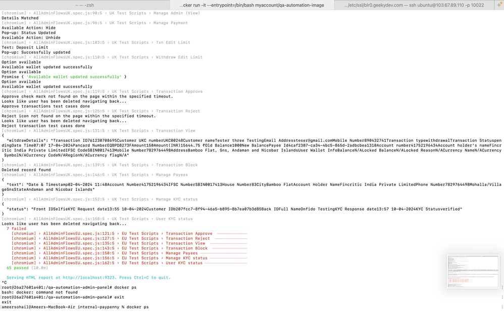

Hello @Patrik S
Thanks for the reply tried with the process you shared above.
If I tried with similar docker commands its throwing errors with 7 test cases are failed.
docker build --memory=1g --memory-swap=1g -t account/imageName:tag -f my.dockerfile .
docker run -it --memory=4g --memory-swap=4g --memory-swappiness=0 --cpus=4 --entrypoint=/bin/bash account/imageName:tag
Whereas if used docker commands without --memory=1g --memory-swap=1g in docker build and --memory=4g --memory-swap=4g --memory-swappiness=0 --cpus=4 in docker run its running all test cases successfully.
docker build -t myaccount/qa-automation-image:latest -f my.dockerfile .
docker run -it --entrypoint=/bin/bash myaccount/qa-automation-image
Attaching screenshots for both scenarios test cases failed and test cases passed successfully.
By this please let me know what sort of changes I need to do.
Note: In pipeline its not passing more than 5 to 7 cases and getting stuckScreenshot 2024-04-22 at 11.32.53.pngScreenshot 2024-04-22 at 11.28.14.png

Ameer sohail
May 6, 2024
Hello @Patrik S
Tried with suggestions you have shared above by adding CI=true, but still its getting stucked, attaching screenshot for your reference.

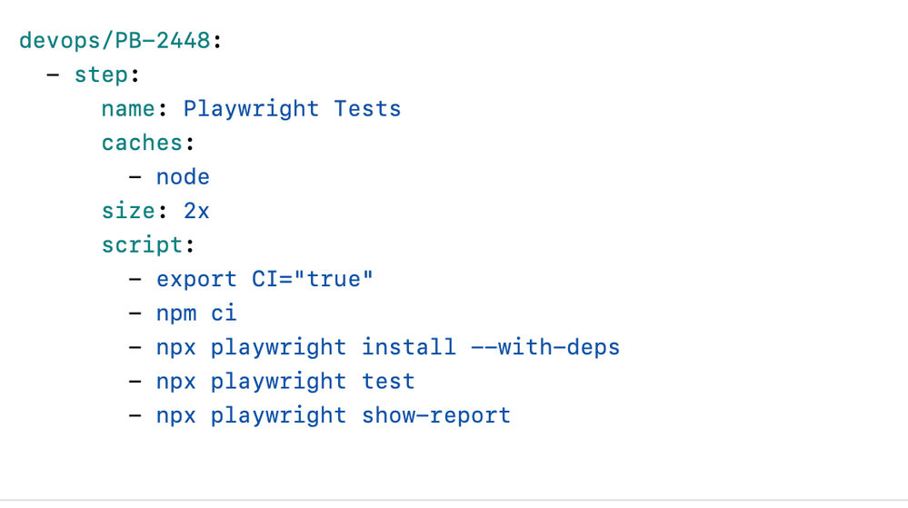

Thanks for executing that test. To rule out a possible memory allocation issue, could you increase that step to size:2x, so it will get double the memory (8GB), and check if the builds also time out?
- step:
script:
- <your build commands>

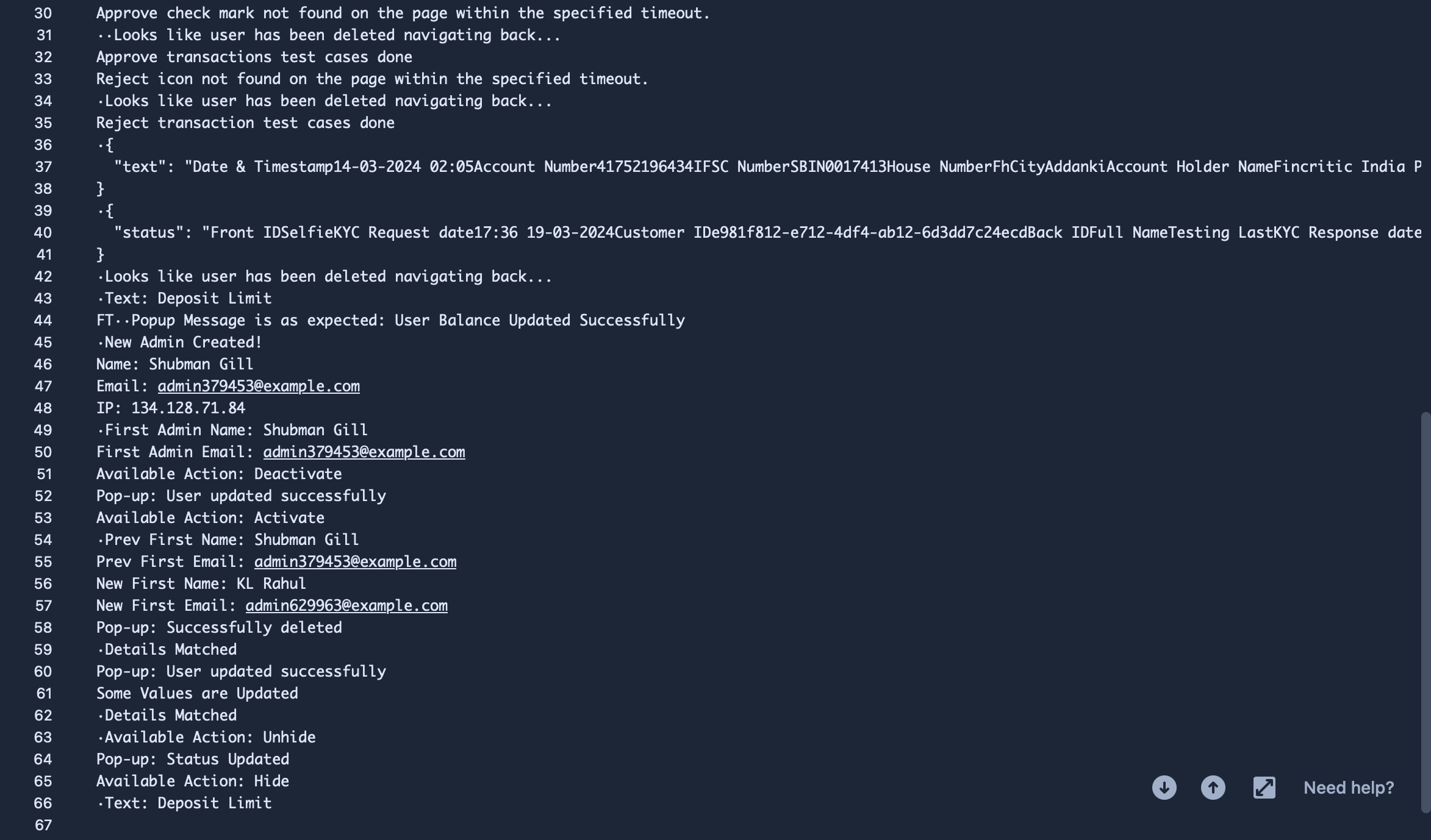

Ameer sohail
May 8, 2024
Hello @Patrik S,
Tried with increasing size:2x, still same issue.
