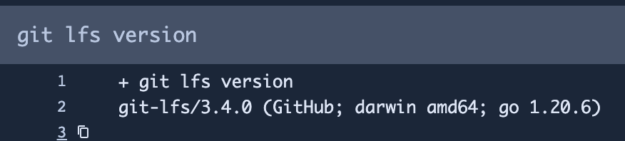

2. LFS version in the pipeline step with clone: lfs: false
Note: this output is identical to what I see on the bash shell

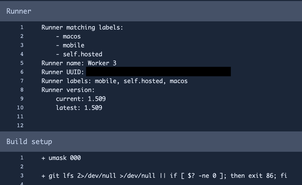

This one fails in setup before it even starts at the lfs check
 steps:
- step: &build-test
clone:
lfs: true
name: Build and test
runs-on: *mobile-macos
