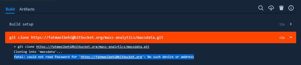

fatma.elbehi
October 19, 2021
Hi Theodora,
After I cloned the second repo in the first one
I received the attached error window
Could you please help?

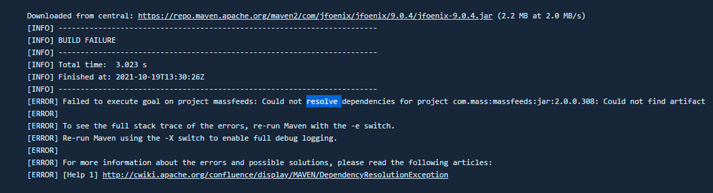

fatma.elbehi
October 19, 2021
Hi Theodora,
For my previous error it is okay now it works fine with me but now I have another issue when I  built the last repository.
best,
Fatma
Theodora Boudale
October 19, 2021
Hi Fatma,
The artifact that cannot be found by the build, is it a jar file that you defined as an artifact in a previous step?
And does the error occur at a step where you clone a repo in the script (like repo-B in my example)?
If this is the case, and if the jar file needs to be in the clone directory for the build to succeed, you may need to move it before you run the build commands.
If you run the following command in the script:
- git clone git@bitbucket.org:workspace-id/repo-b.git
a directory named repo-b will be created inside the build directory for the clone.
If you defined in a previous step a certain jar file as an artifact and if it exists in the build directory, you can move it inside repo-b clone with the following command
mv myfile.jar repo-b
Replace the name of the jar file and of the clone directory with the ones applicable for your case.
