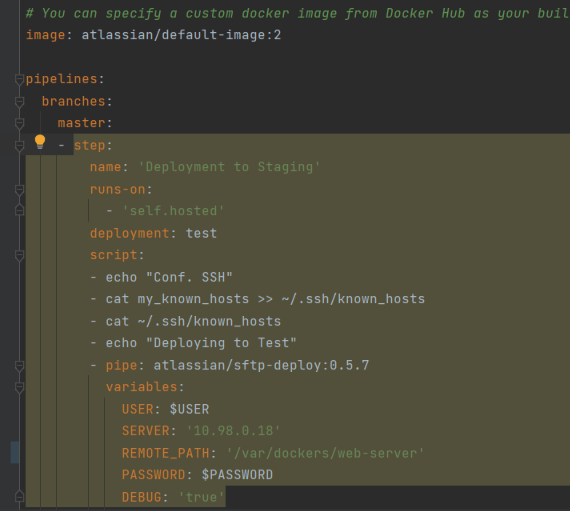

I'm trying to deploy to an testing server. As my server can't be accessed from internet, I’m using a self.hosted runner to copy my files and deploy inside my network

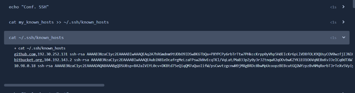

As my server is on a local network, I use cat command to add my know_host information but i always get a Host Key Verification Fail.  I'ts like the sftp pipeline doesn't read from the same know_host file.
Any help will be appreciated.
YML File
Cat Log

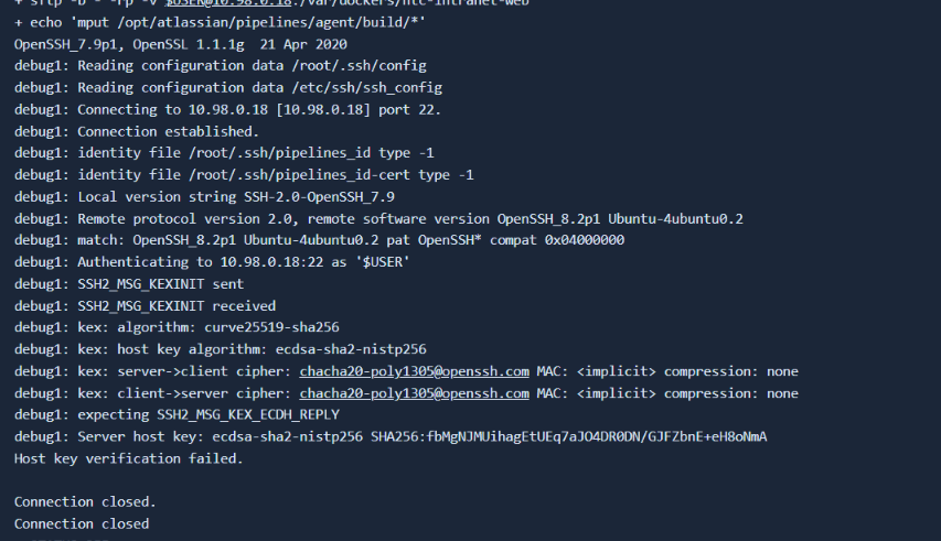

Error:

@Caleb L_ Power. It is worked in shh-run, because StrictHostKeyChecking is set to no by default there.

Also you should put your known_hosts file here: /opt/atlassian/pipelines/agent/ssh
according to logic

@Ricardo hi. Thanks for your question.
Currently our team are working on supporting the default ssh_key for self hosted runner.
Please, for now use your custom created ssh key. See how to generate encoded ssh_key under the section:
Use multiple SSH keys in your pipeline
pass the output in base64 format into bitbucket repository variables with name i.e SSH_KEY and use it in your pipe:
script:
  - pipe: atlassian/sftp-deploy:0.5.8
    variables:
      USER: <your user>
      SERVER: <your host>
      REMOTE_PATH: '/var/www/build/'
      LOCAL_PATH: 'build'
      SSH_KEY: $SSH_KEY
      DEBUG: 'true'
Regards, Igor.
