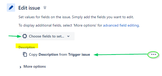

@Villarasan
No need to use JSON at all in this case. Just choose the Description field from the "Choose fields to set" picklist, then click the options (the 3 dots) for it and select Copy from trigger issue.

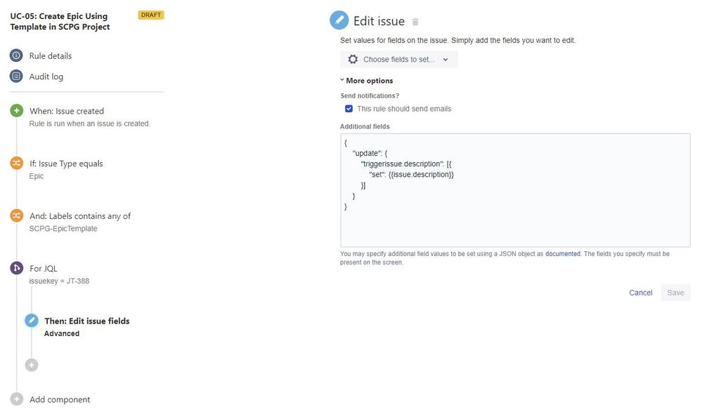

Villarasan
September 7, 2022
Hi Curt, I want the description value from the current issue (JT-388) should be updated to Trigger Issue, so exactly opposite to your solution. please help me in getting that reverse update.

Villarasan
September 7, 2022
Thanks for your response Stefan. I just did that, but I am not sure how to get the description value of template issue (JT-388). attaching the screenshot of the rule.

Stefan Salzl
September 8, 2022
Hi @Villarasan
The JQL branch moves issue scope to the issue(s) that are the result of your jql. Hence: everything within the branch will be processed on these issues.
It looks like you are running on Server/DC. Unfortunately the lookupIssue action is not available there (as far as I know). In cloud I would use this action to store your template issue in a smart value and invoke in the edit issue action.
What comes to my mind would be an API call (via send webrequest action) that selects the required template issue and using it´s result within the edit issue action.
See the documentation in the link below:
https://developer.atlassian.com/server/jira/platform/jira-rest-api-example-query-issues-6291606/

Villarasan
September 8, 2022
Yes Stefan, we are using Jira Data Center version. Let me try the Web request action. If you have any examples it will be great!
