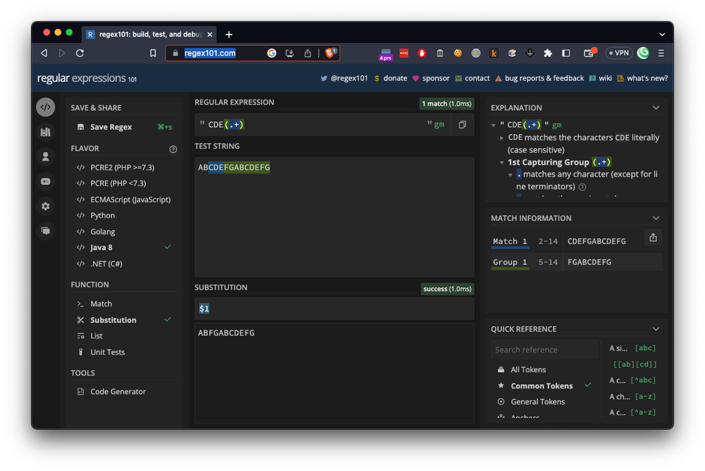

Hi Darryl, Thanks for the tip - so is this regex just replacing the first occurrence (which is what I wanted), or all occurrences?
Darryl Lee
March 25, 2023
Oof, was going through my old answers, and realized I didn't reply @Chris Smith , sorry - yes, this replaces only the first occurrence of REM.
Even though the function is called replaceAll, what we are replacing is CDE+"everything that follows it" (that's what the "(.+)" is about) with just everything that follows it (that's what the "$1" is about).
There's only one instance of CDE+"everything that follows it", so in effect it's only doing one replacement.
Regex is weird. I know. I tested this here: https://regex101.com/
It's a super-useful site:
