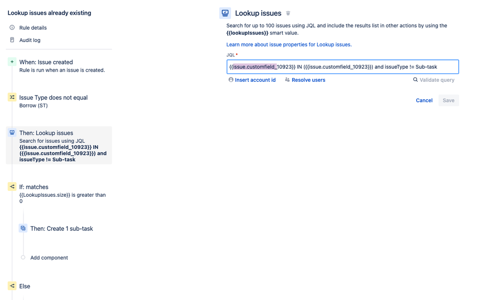

I gave it a try and it is progress. The error it gives me is that it either does not exist or I do not have permission to view it. This is how I have set it up. Maybe you can see any errors I have made? Untitled.png
Mark Segall
February 3, 2023
Your Lookup query needs a tweak.  Try this:
cf[10923] IN ({{issue.customField_10923}}) AND issueType != Sub-Task

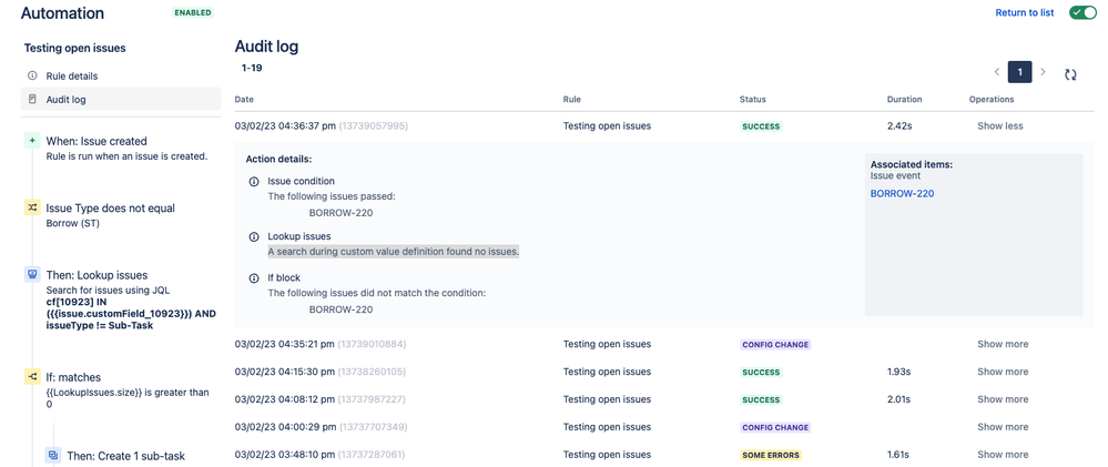

Hi @Mark Segall so it ran successfully, but it did not find "parent issue" and create a sub-task in that related parent issue sadly.
I will keep trying though
Mark Segall
February 3, 2023
Can you please share a screenshot of the audit log for the rule?  This will help me get better understanding of what's happening vs your expectation.
Mark Segall
February 3, 2023

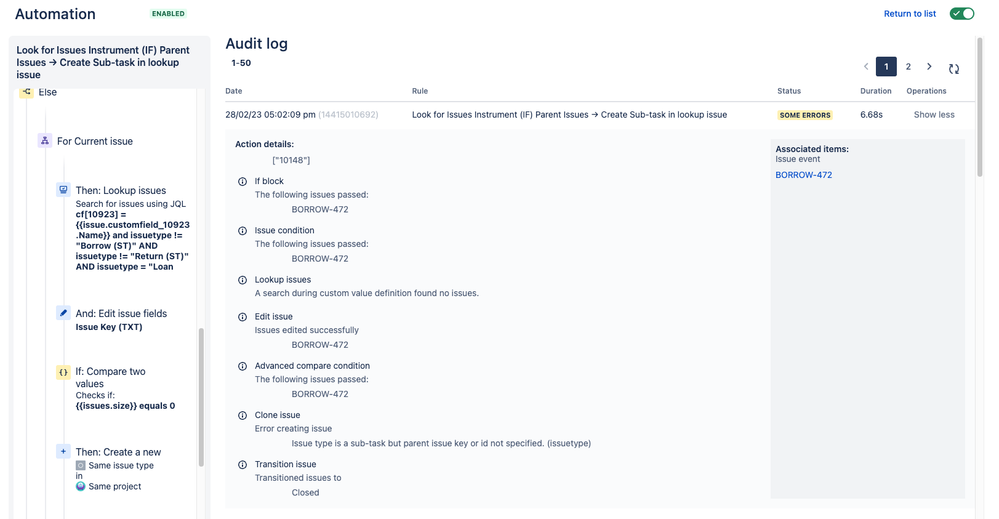

Ok - So in this instance it found no matching issues.  If this is an expected outcome, you'll want to update your ELSE condition to include whatever you want to have happen which is where I'm still not 100% sure I understand.   You'll want to add the appropriate action as a component under that Else condition:
  • Create a request
  • Create a sub-task on the issue that triggered the rule
  • Create a request with its own sub-task

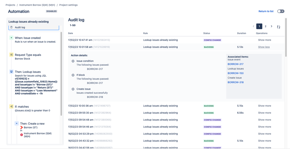

I have managed to refine the automation and it is looking up the exact parent issue I am looking for now.
However, it i creating the sub-task in the newly created parent issue which is created from the request. I thought perhaps I could use a move action to move the sub-task to the issue that resulted from the lookup issue portion? However there is no action at present that allows you to move an issue in automation.

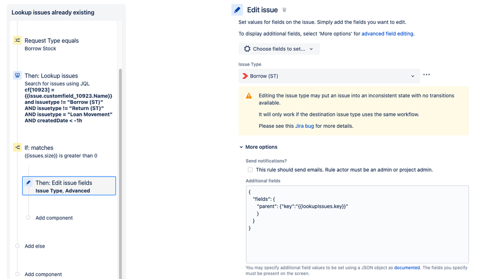

I thought maybe I can try and use Advanced fields.
Please see attached. So essentially we want to move BORROW-317 to be a sub-task in BORROW-150 and not create a whole separate sub-task. Borrow Automation .png

Yes - You need to change the parent in the advanced portion of the Edit Issue:
"fields": {
"parent": {"key":"{{lookupIssues.key}}"

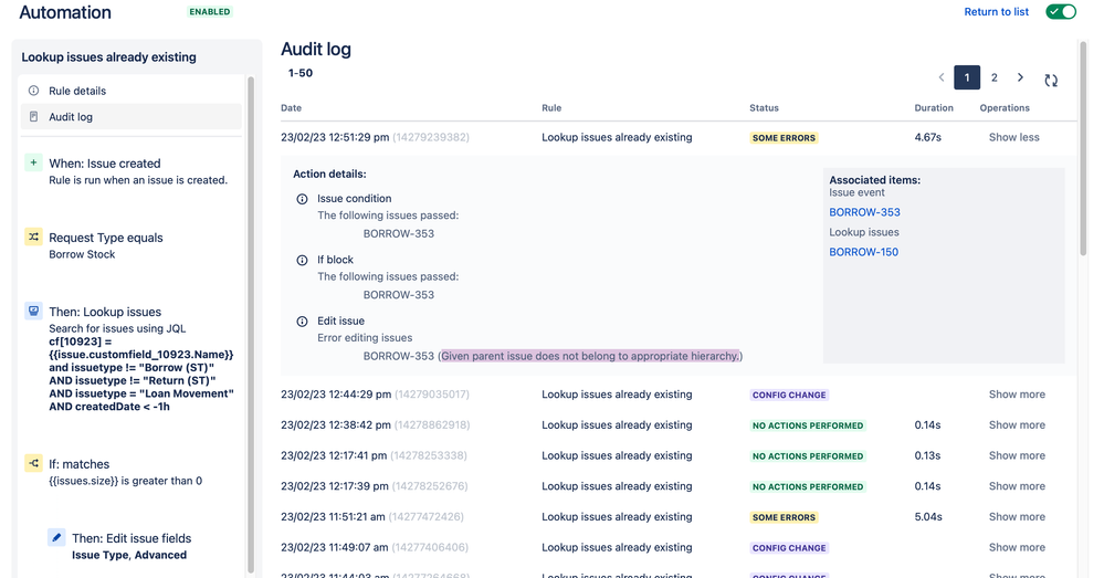

Slowly, but surely, making progress. I have the following issues when adding the above to advanced fields.
Any ideas on how to go about it? Not sure what the error means exactly.
Mark Segall
February 23, 2023
That message means that the syntax is right, but the link is breaking the Jira hierarchy (e.g. making a task a child of another task).  Can you please confirm that when you say, "Sub-Task" that you actually mean the "Sub-Task" issue type?
If it is any issue type other than sub-task, this approach won't work and instead we'll need to look into some type of linking strategy to create a logical parent/child relationship rather than one that is enforced (which is how the Parent field works)

Yes, we created a sub-task issue type named Borrow (ST). Do you think this will cause an issue? Borrow ST.png
Mark Segall
February 23, 2023
Hmm... That shouldn't be a problem, but perhaps its trying to set itself as a child of another issue type that is a sub-task issue type category?

So the issue that we looked up in the first part of the automation is what we want to 'move' the sub-task to. And that issue is a Parent issue that is why I am a bit perplexed. Maybe I just need to play around with it a little more... It is getting close and I just need that one missing piece and it will slide into place - I HOPE!
Mark Segall
February 23, 2023
Hmm... I know changing the sub-task parent should work because I've tested it successfully in my personal environment.
Can you please share a screenshot of the Edit Issue action so I can make sure everything looks ok?

February 23, 2023
Mark Segall
February 24, 2023
Thanks for sharing... I see the issue now.
You won't be able to convert an issue to a sub-task.  As a workaround, you could do this...
Delete the Edit Issue component from your rule and replace with this:
  • ACTION: Clone Issue
    • Issue Type = Borrow (ST)
      Since this is a sub-task issue type it will pop up a Parent Issue option
    • Parent Issue = {{lookupIssues.key}}
    • (Optional) Linked Issue
      • Clones | Trigger Issue
  • ACTION: Transition Issue (To Closed)
This will clone the issue and link it to the trigger issue and close out the trigger issue.

After the lookup condition I am trying to get the automation to create a NEW Request if there was no results rendered in the lookup, but that renders errors and does not create anything.
I tried adding it into the "Else" section but still no success do you have any suggestions? I cannot even seem to create sub-tasks beneath that. I have tried branches, I have tried pretty much all I can think of and thought maybe you would have a suggestion. Thanks in advance.

Can you please share the screen shot of the error entry in the audit log and a look at the create issue action you're trying to employ?
Robynne Barnard
February 28, 2023
So it will create an issue in this instance, but I have set it that it deletes the issue for the lookup as we have a cloned sub-task, as we set last week.
So if I do not delete it then it causes duplication with the lookup automation, but then causes chaos when a new issue needs to be created and no lookup is found. Audit Log .png
Mark Segall
February 28, 2023
I'm not quite sure I understand all of the components under the Else condition.  You should only need to have the Create Issue action under the Else condition.  The error is indicating that you're trying to create an issue type that is a sub-task but not providing a parent key.  I believe the parent should simply be set to the trigger issue.
