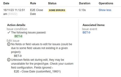

I have set up an automation in JIRA that works as follows:
  1. WHEN: Issue transitions from (in progress, resolved, reopened and/or opened) to (closed).
  2. IF: Issue type is one of (task, sub-task, story and/or bug)
  3. THEN: Edit issue field (Custom field date picker) using the following smart value: {{now.jiraDate}}
When I tested the automation, the custom field wasn't modified. When consulting the audit log, it shows that the issue met the conditions (so steps 1 and 2 are properly programmed) but when performing the edit action (step 3), no edit was made. JIRA suggests 2 possible reasons:
  • No fields or field values to edit for issues (could be due to some field values not existing in a given project) - not the case, as I already checked the custom field is included within the screens of the project.
  • Unknown fields set during edit, they may be unavailable for the project/type. Check your custom field configuration - neither the case, as this custom field is configured to be available for all projects in our instance.
At this point I'm stuck and I don't know how to proceed - any ideas? Thanks a lot in advance!

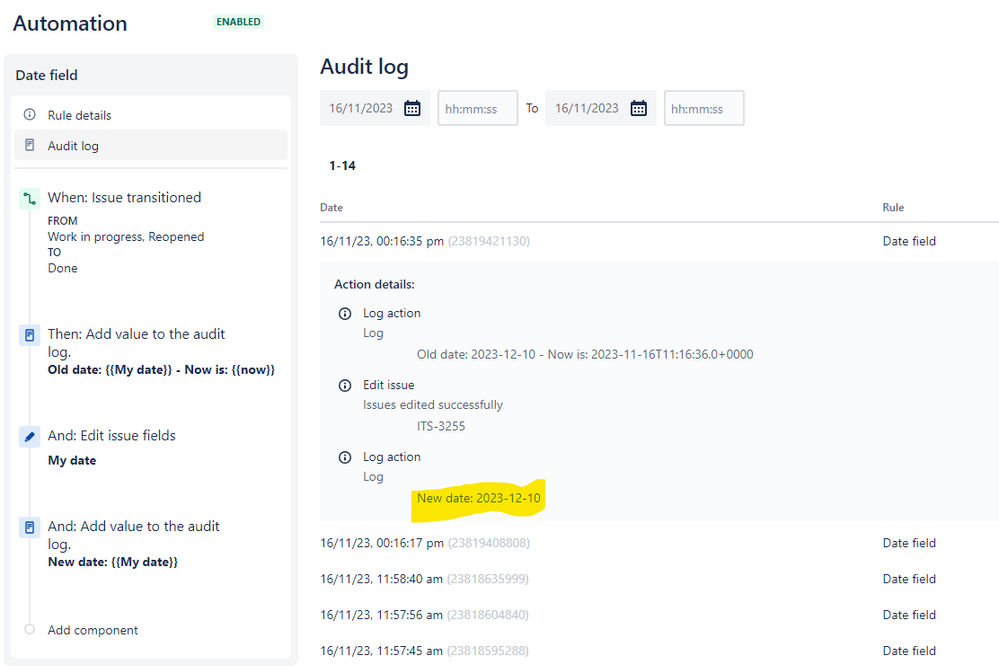

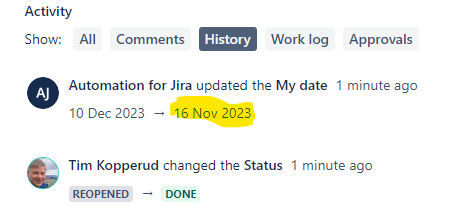

I'm not able to reproduce this problem, as you see here.
The rule
The result in history log
As you see by the yellow markings the My date field was not visibly updated during the rule execution itself (first yellow marking), but it shows changed in the issue itself (second yellow marking).
Just so I understand the exact problem for further investigation. Is the variance mentioned above (rule update ves history update) related to your problem, or is it that the field isn't even updated in the issue history?
It might be helpfull if you are able to attach images of the rule and of the issue history (like in my example above).

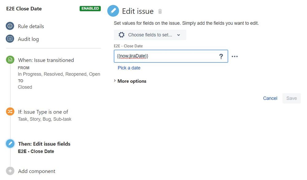

Thanks for the quick response. The main problem I'm facing is that my custom field (E2E Close Date) is not being edited as I want to.
Please find attached screenshots both for the automation and the audit log.

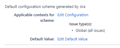

Do you see the field E2E - Close Date on the issue BET-9 itself? Are you able to set the field manually from that issue?
Though a field doesn't actually need to be included in any screens to be set, lack of seeing the field can be an indication of a context problem. Try check your custom field context
  1. Press the Cog icon (upper right corner) and select -> Issues -> Custom fields
  2. Find the field E2E - Close Date
  3. Press the Ellipsis menu to the right and select Context and default value
Confirm that the project BET and the issue types Tasks, Story, Bug and Sub-tasks are included in the applicable context.
If it states Global (all issues) the project BET and the issues types are included (global context is not reccomended though so it might be a narrower scope in your setup).
The image below shows an example of the global context configuration.
You might attach an image of your context configuration if you're uncertain.

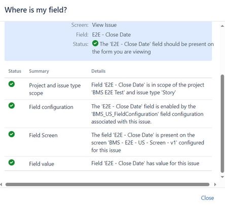

Thanks for the clarifications but I had already checked that. I even run the "where is my field" diagnosis and everything seems correct (see the screenshot below)
Also, the field is being shown on the test issue. The problem is that the automation is not being done, as it doesn't get updated when I transition to Close status.

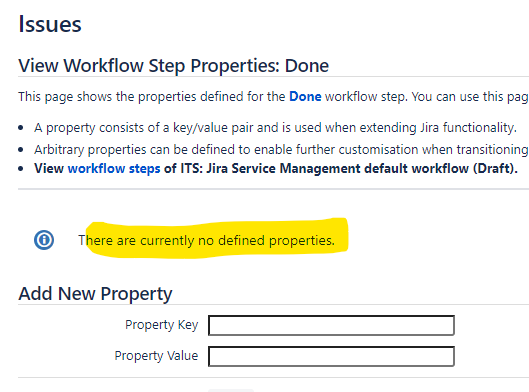

1:
Have you confirmed that the user executing the rule has Edit permission on the issue?
2:
This is probably not the reason, but can you check if any edit restrictions are set on the Close status in your workflow? If the user executing the rule can manually edit the issue it is not set any edit restrictions.
3:
You might also test if the rule works with another user as the Actor , e.g. yourself.
TimK

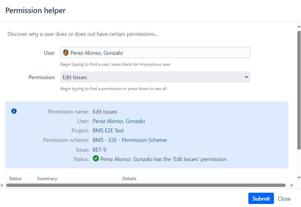

According to your first point, I also checked i had full edit permissions on the issue - please see the screenshot:

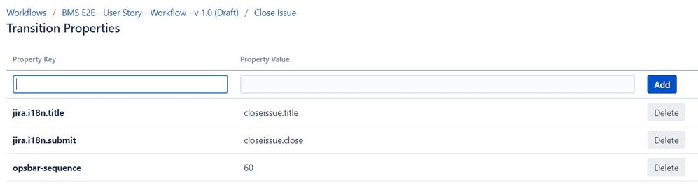

Regarding any possible restrictions, I haven't seen anything particularly noticeable on the transition that goes from Opened to Closed status in the workflow.
Gonzalo Perez Alonso
November 16, 2023
Here's the screenshot showing the prior restrictions, sorry:
Tim Kopperud
November 16, 2023

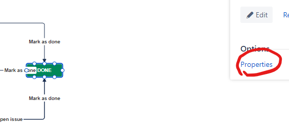

Hi @Gonzalo Perez Alonso, I was thinking of the Status properties for closed, not the Transition properties. See my first image in my last comment. Select the Closed status and press properties.
Also, when you say you have full edit permission, does the rule execute as you as the Actor
TimK

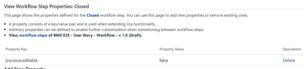

Here's the screenshot with the Closed status properties:
Maybe that jira.issue.editable should be in true, to let the automation work?

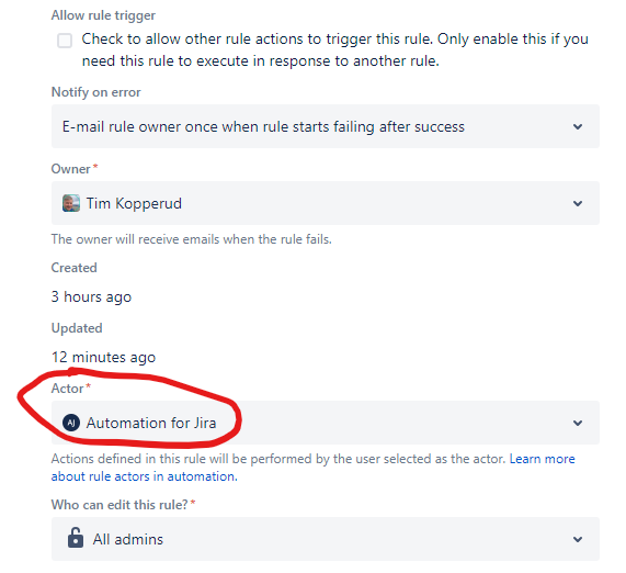

And here's the screenshot showing that I'm the actor of the automation:
Tim Kopperud
November 16, 2023
Your status Closed has been locked for editing. That's why the rule won't set the date.
This image shows that edit is disabled on the status.
If jira.issue.editable is set to false no one will be able to edit the issue.
ONe option is to remove the property, but notice it has been added by a Jira admin on your instance, so the reason for having it should be understood before removing it.
Or you can add a new property to grant the rule actor edit permissions on the issue and still deny all other users. Have a look at this article
TimK.
