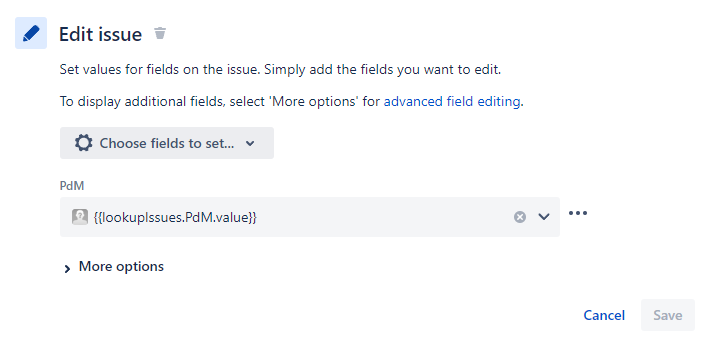

First thing: smart values are case sensitive. So try to change to {{lookupIssues...}} (capital „i“) in your esit action.
furthermore (as the field is still a list) could you try the following in your edit action:
{{lookupIssues.PdM.value}}
see the documentation below:
https://support.atlassian.com/cloud-automation/docs/examples-of-using-smart-values-with-lists/
Please let me know if this works.

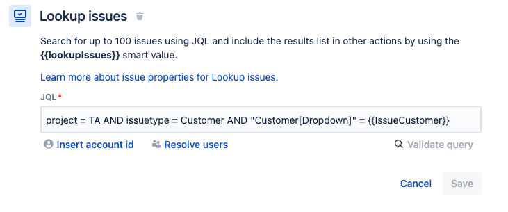

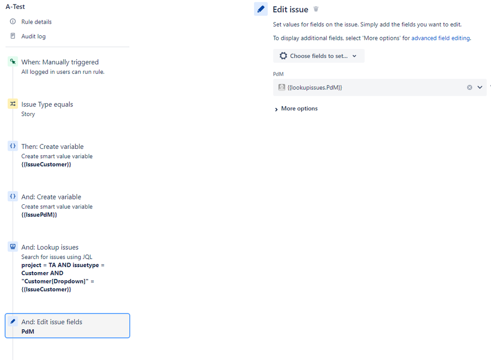

Adam Hasselgren
September 8, 2022

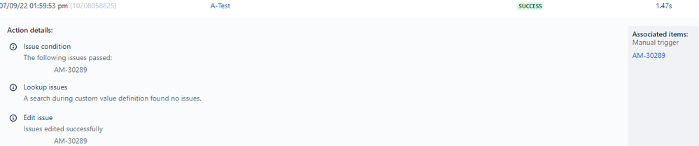

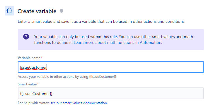

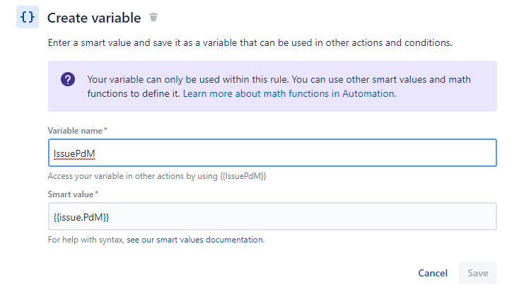

Still no luck..I've included all the screenshots from each part of the automation just in case I'm completely missing something
Stefan Salzl
September 8, 2022
It seems your JQL doesn‘t even deliver any results.
I would suggest the following:
  • before your lookupIssue action add a „audit log“ action for debugging and let it just wright the value for customer field in your issue —> {{issue.Customer.value}}
  • it should not be necessary to store this value in a variable —> try to use the smart value from previous point in your JQL in the lookupIssues action (instead of the variable)
Best
Stefan

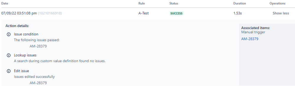

Adam Hasselgren
September 9, 2022

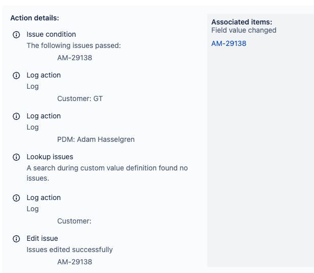

Screen Shot 2022-09-09 at 9.23.36 AM.pngScreen Shot 2022-09-09 at 9.24.01 AM.png

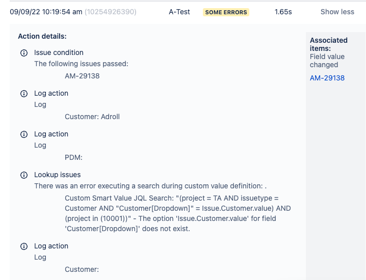

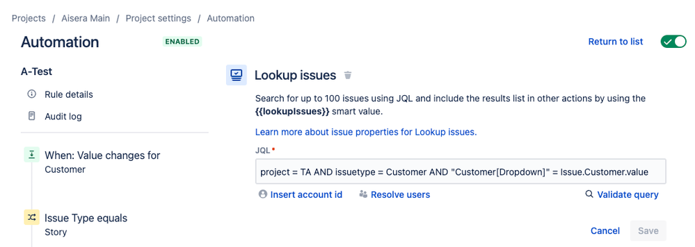

So it looks like the PdM field is the thing giving me trouble.  I need to use {{issue.PdM.displayName}} for it to work correctly so getting there.  I now think I have an issue with my lookup...first issue I see is it doesn't want to display the customer from the lookup (log: Customer: {{lookupIssues.Customer}}
I did notice it can't "Validate query" as it's greyed out.  Is my syntax incorrect?
Stefan Salzl
September 9, 2022
Hi @Adam Hasselgren ,

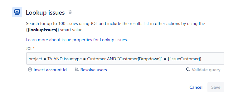

yeah as I mentioned before try to use the smart value directly in your lookupIssues.
so instead of your variable name (as shown in your last screenshot) use {{issue.Customer.value}}.
The JQL cant be validated as it uses a smart value which is resolved during runtime. This depends on the issue the rule is activated by.
You could just copy the jql and replace the smart value with a real example of one of your issues (like let‘s say you have Issue A and in the this issue the customer is John Smith —> try your jql in the normal issue search with „John Smith“ instead of you smart value)

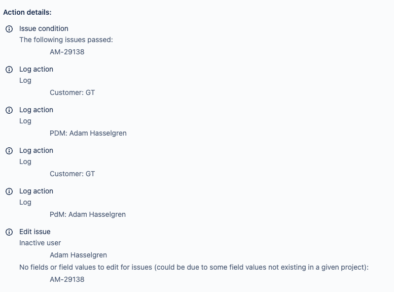

Screen Shot 2022-09-09 at 10.26.13 AM.pngScreen Shot 2022-09-09 at 10.26.41 AM.png
So the weird thing is in my JQL I'm only specifying the project "TA" but when I look at the log it's adding another project which is "AM".  Would this be my issue?  I have must customer record in TA but the tickets it's looking up against is in "AM".  Is there a way to modify this or do I need to move my "Customer" issue type into the "AM" project?

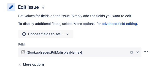

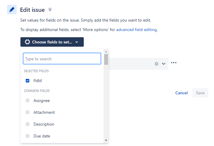

I updated it to global and now I feel like we're sooooo close..It's sees the correct values, the JQL is fixed, however when it tries to update the field it says I'm inactive.  It's the same custom field and I'm a valid user in both projects.

Stefan Salzl
September 10, 2022
Hi @Adam Hasselgren
could you try to just use lookupIssues.PdM or lookupIssues.PdM.value in your edit action?
The displayName is mainly meant for user picker fields. As far as I got your description you are getting the information/value from a select field (single choice). So in this case the result is already the expected value (from a user picker field you would get the id and to use the plain name you would use displayName).

Adam Hasselgren
September 12, 2022
Brilliant!  I just used the {{lookupIssues.PdM}} and it worked!!!!!  Thank you @Stefan Salzl for all your help!!!!!

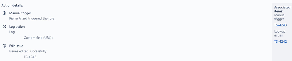

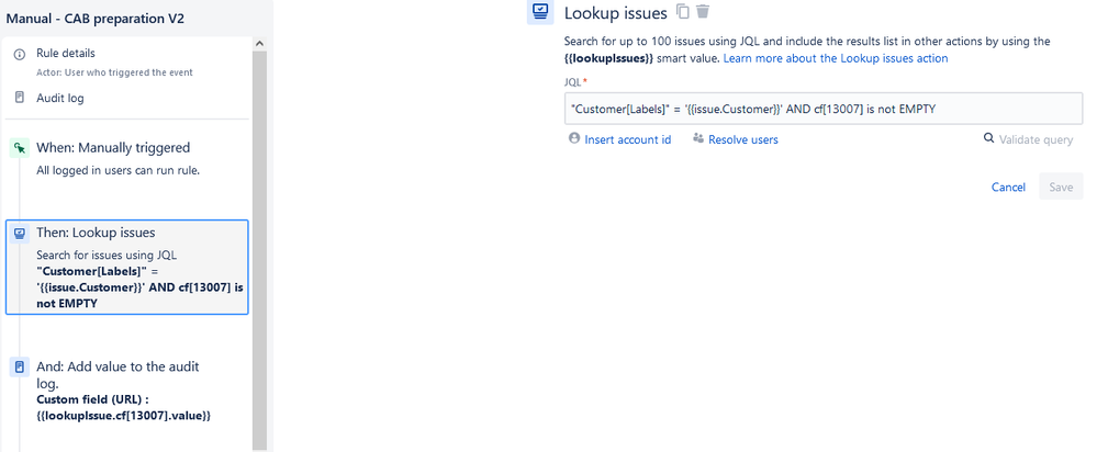

I'm trying to implement the same kind of logic but it seems I'm not able to retrieve
my custom field from my lookupIssue to put it in the audit log.
Here's the automation details:
Here's the audit log:
I've no error, the rule is a success...
I've tried with and without .value but it's never working.
Any idea ?
My custom field is a URL, could it be due to a known limitation with this kind of field ?
