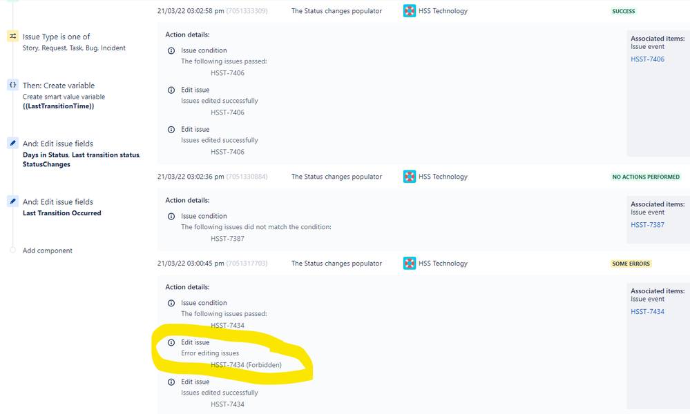

I'm getting occasional errors from a rule and the detail in the audit log is "edit forbidden". But this only happens randomly. Below is a good example, where in a short period of time, in the same Project (it's a global rule) there was a successful, a No action performed and a "some errors" with this stage error.
The field "StatusChanges", is read only, as in, it isn't configured for "Edit screen" so that people cannot manually mess with the entries added by the rule. This works...absolutely! and as shown below, works in this project only minutes apart.

Here are the clues I detect:  global rule (i.e. will run for various projects using various project configurations), intermittent errors, and the inability to edit an issue.
This suggests that there is a configuration difference between projects causing this problem. You will probably also see consistency in which projects have this error, and which projects do not.
I would check these areas, comparing between projects that work and projects that don't:
  • Difference in Permission Scheme (preventing the issue from being edited)
  • Difference in screen or field configuration (preventing the field from being accessible at all, or from being editable)
Also check how this rule is configured for the "Actor" field. Ensure the configured Actor has the required access to perform this edit.
A helpful thing for situations like this is the Jira Permission Helper:
https://YourInstance.atlassian.net/secure/admin/PermissionHelperAdmin.jspa
(the above is the Jira Cloud link; replace the YourInstance part to match your Jira).
It can easily pinpoint many configuration details that can prevent a user from taking a specific action on a specific issue.
Let us know what you discovered!

Thanks @Mykenna Cepek I have checked most of those and indeed i do get "explainable" errors from time to time with such (global) rules. But in this case, their is no consistency as the screenshot demonstrates (3 examples all in the same Project, where 2 out of 3 work, one doesn't)
I did this morning wonder if it is as @Doug Levitt points out, that it is to do with traffic/volume/stability of Jira at a given moment. Based on this occurring yesterday Jira Software Status - Various features are not working for some Atlassian Cloud customer around the time I started getting seemingly random failures.
