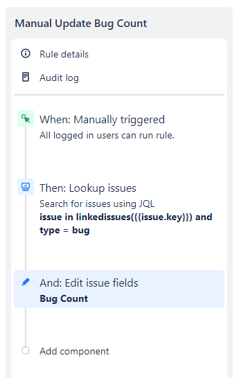

I created an automation in a project that is a manually triggered rule (for now).

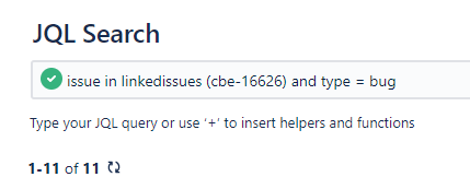

In the automation, I do a lookup with the following query: "issue in linkedissues({{issue.key}}) and type = bug "
When I run the same query in ScriptRunner, I get 11 results for the target issue, so I believe this is correct:

In the automation, I then edit the issue using {{lookupissues.size}}.  When I run to automation, the field is set to zero, and not the expected 11.

The field is available on the project.  The only thing that I can think of is that the linked issues is a part of a separate project?  Does my automation have to be moved to global because of it?
Project being run against is CBE-XXXXX Linked issues  are BUG-XXXXX

Prior of changing the rule to global, try the following query on your lookup component:
issue in linkedIssues(CBE-16626) and issuetype = bug
Click validate query and see how many issue it will return

Thanks @Alex Koxaras -Relational- .  I tried it on both the project specific automation and the global.  Project specific returns 0 and global returns 11.  Looks like that is my problem.
